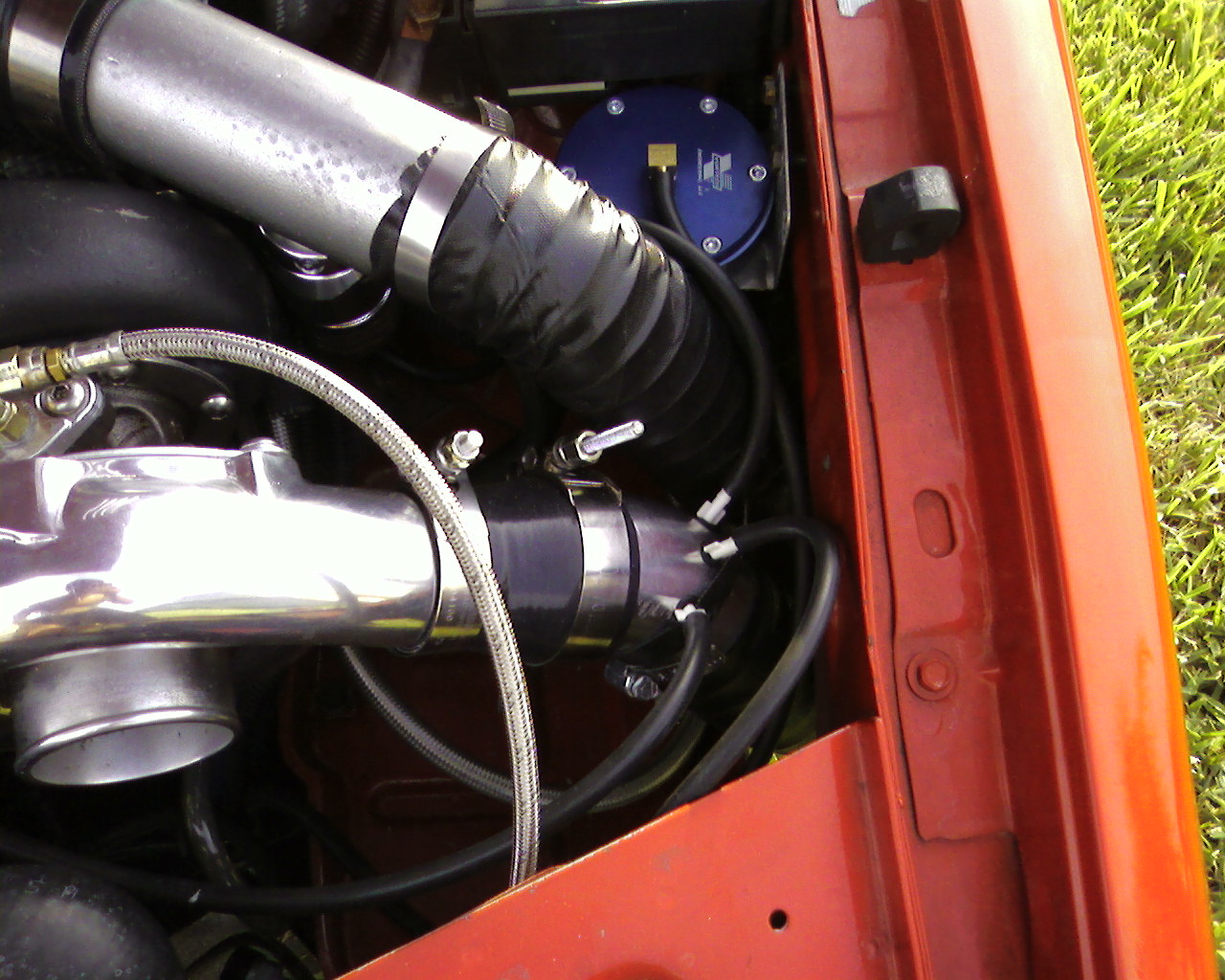

                    • #55
                      I took the charge pipe off and drilled 3 holes. bov,wg and fmu. Now I used a grommet and a plastic fitting. It is pretty loose thought. Now when I was driving it I noticed that the car drives it self at 1500 rpm. Basically I dont have to touch the gas. Also I get no A/F reading when this happens. How touchy are those lines. I will post a pic. give me a sec
                      • #56
                        here you go.

                              i would get brass fittings for the holes. under pressure i dunno if the rubber gromments would hold it. like i said before you don't want them to blow out. or have metal nipples welded on.

                                You are still referancing boost for your BOV? You need to hook your BOV to the plenum.
                                If those fittings are loose, and you have a MAF ECM, then you have a vac leak.
                                Wait, it looks like a you do have a MAF, and it's after the turbo, it needs to be before the turbo. The MAF shouldn't see boost.
