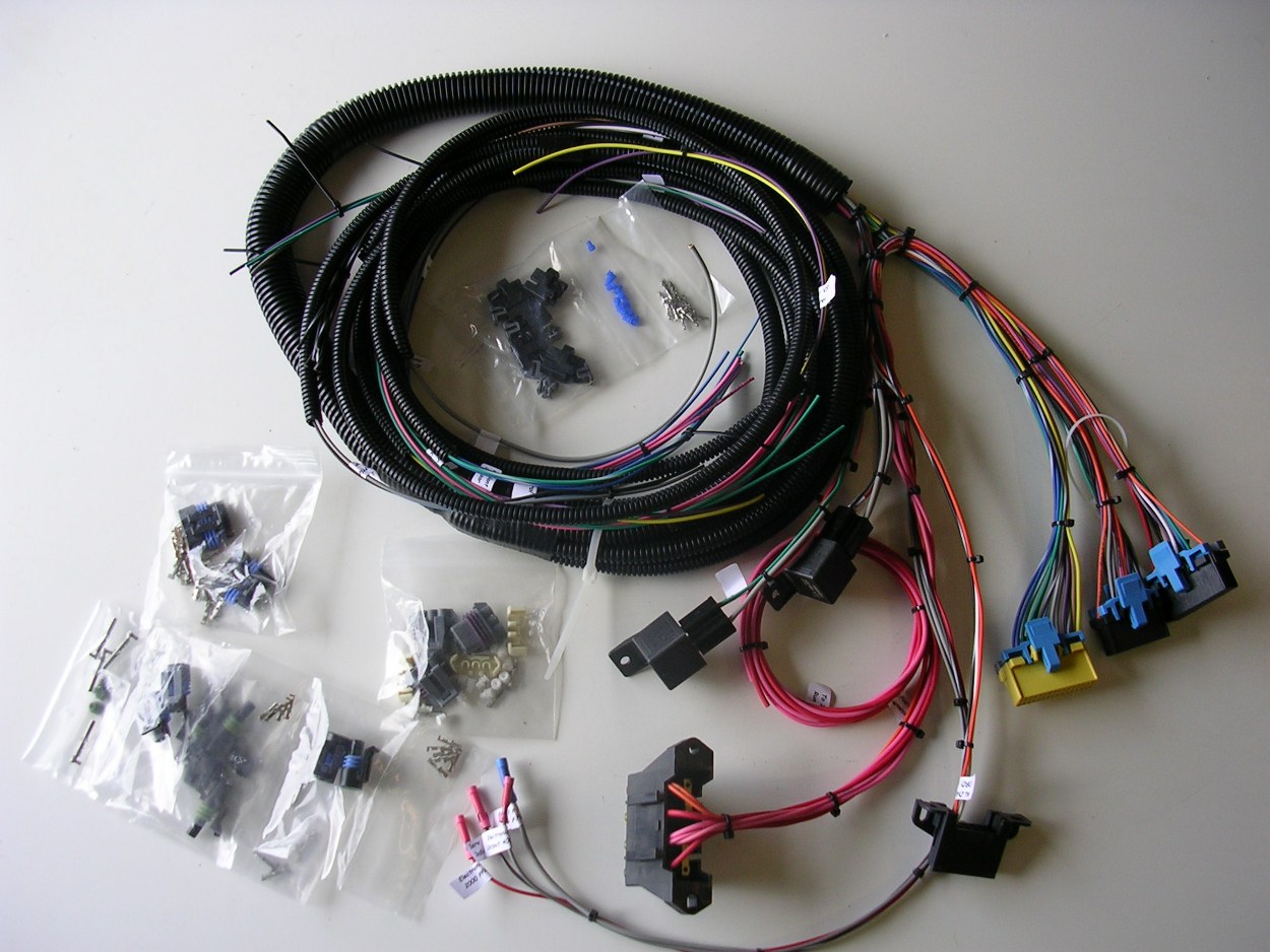

                          • Added a new product that may be of interest to some. We have been selling complete harnesses/ECMs for swapping 60V6s into MGs and other cars. We have decided to add a DIY standalone harness to our lineup for those who would like to build their own. The harness comes partially assembled with the connectors for the engine not being installed. You would select what injectors and MAP Sensor that you are using. Injector plugs can be EV1, EV6 or Multec II and MAP sensor connectors can be old or new style. We supply all of the connectors and terminals for the engine and you trim wires to fit and crimp on the ends. It is made using GLX multi strand wire with thick wall covering and all new Delphi/Packard connectors to insure proper connection at every sensor. Complete harness with connectors is priced at $425 and includes instructions for installing connectors.
