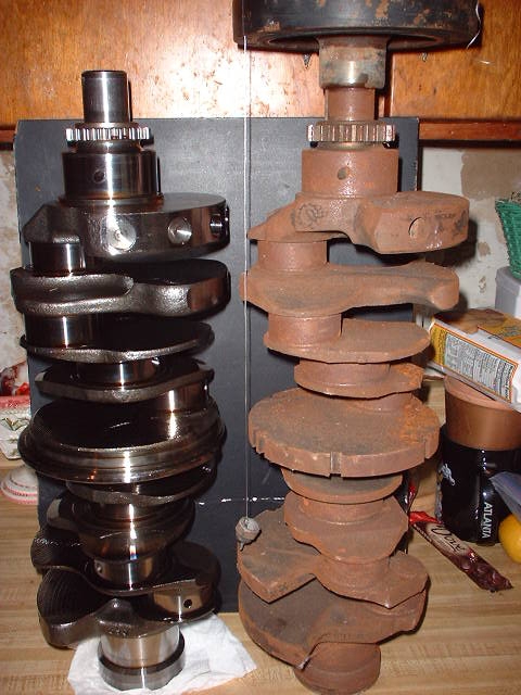

I have finally given in and am making a batch of internal trigger wheels for the LX engines. My attitude was that there wouldn't be that much demand for them due to all the work and expense of installing them but after being asked repeatedly, I am moving forward with them. Using one requires removal of the crank, pressing the old rings off, properly pressing the new ring on and reinstalling the crank. Of course, a spacer must be used to move the 7X CPS to the correct position. The kits will come with the trigger ring and CPS spacer. They should be ready for sale in a couple of weeks. Price has not been established yet.
First piece off the machine - Dimple between slots marks which side goes towards front of engine.
Now I need to find the correlation between the two rings and mark the new rings. Thanks Dave.
