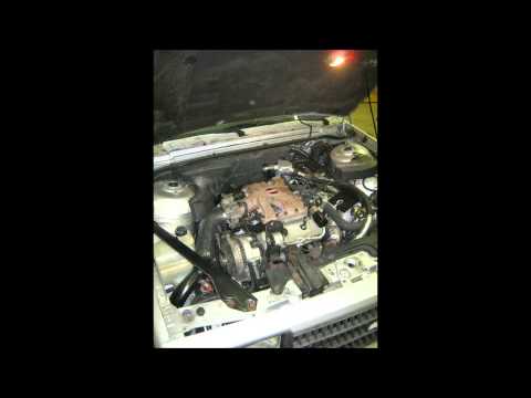

        This was almost the end:
        This is the new beginning:
        I'll be doing more builds. My next one won't be a 60°V6, though. It will be a Buick V6 / 4T80E build.

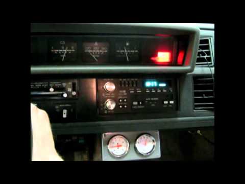

                  • Here is a video which better explains the radio amp problem and the solution I used.
                    David Allen - Northport, AL
                    • Originally posted by The_Raven View Post
                      Yep, that exactly what I was thinking, that the amp is seeing an issue with the input, which is a signal issue from the radio.
                      It had a pop over the speakers during the power-on phase, without the delay. Now there is no pop.
