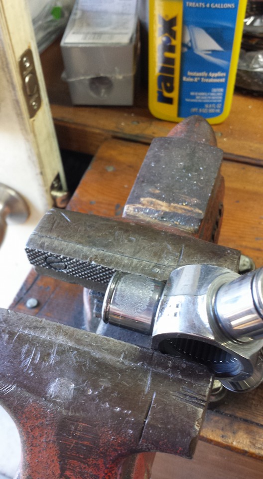

    • SO yeah things never work the first time... I should have thought of this but when I did the outer CV's for N-body brakes the whole outer assembly was swapped onto my axle shaft... This time I only had the inner output stub for the 60e-HD and it didn't come with the tripod inner parts. Come to find out the Beretta parts, or the ones used on this axle do not fit into the larger splined output stub needed for the 60e-HD diff.
      Hopefully Jeff from EP has one of these tripod's that he can send to me so I can get this axle back together.
      Beretta output stub on the bottom.. you can see the difference.

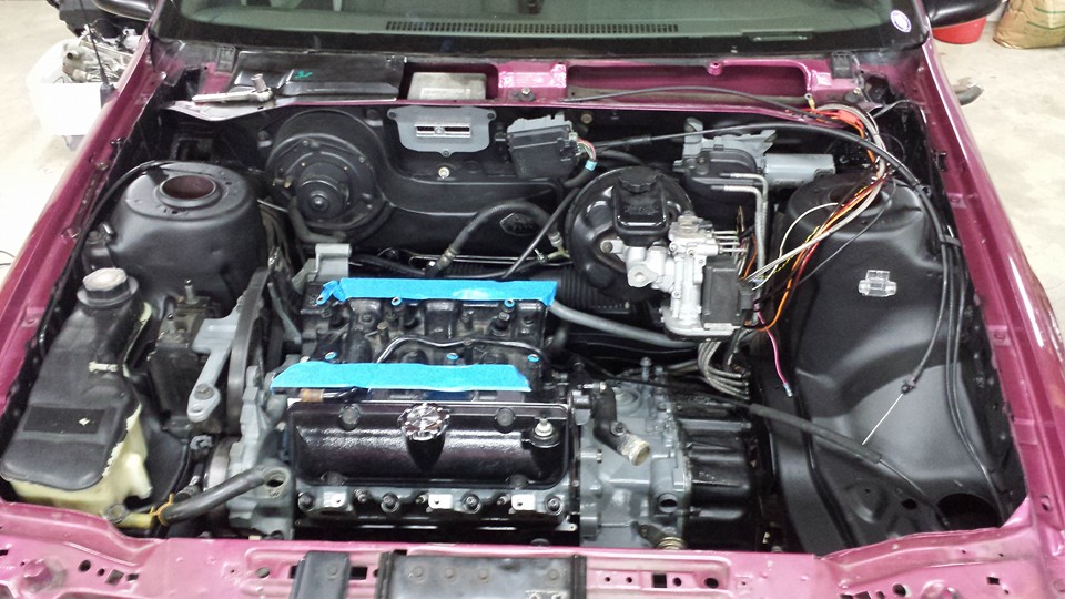

      I got my pushrods yesterday as well... Tonight I'll be installing those slapping on the rocker covers and then trying to figure out how to get the engine out of my basement... LOL
      • Lmao! How did you get it in your basement in the first place?
        • It weighs a lot less when in individual pieces I do have a ground level door, well the basement is about 8" lower than the door, but the bigger question is will the stand fit through the two door frames it has to go through... According to my trusty tape measure it should by 1"... but we all know how well that works out.
          • Slow and steady wins the race... LOL
            Got it out of the basement rather easily... Fit through the doors and was able to lift it up and out of the side door with ease.
            And it's made it's way back into the car... SO much room doing this with no wiring harness in the car... I may just pull that every time to make this job easier.

                  Majorly stuck with the axle though. Tripod from the W-body is 34 tooth and larger diameter axle... Mine is 32 tooth and .955 axle diameter, so I can't just swap tripods. I have a W-body axle coming so I can take it all apart and figure out if that tripod perhaps has the same diameter pins that the rollers run on... if they do then I can just swap the rollers over and maybe it will all be good. Worse case I need to put the factory open diff back in the car to get it on the road and through emissions on May 20th and get some custom axles ordered... I figure that will take a while and may f-up my plans of drag racing at Beretta Fest since if it's still the open diff I'm not risking blowing that up down in Mississippi.

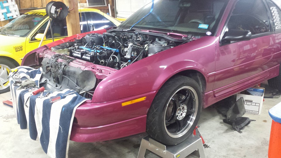

                  • Other updates Drive line in

                    Headers on for looks...

                    I will be re-moving the suspension again tonight to clean it up and prep for new rear bushings. I'm hoping the axle length I need and parts necessary will have some combo out there and not require a custom length shaft but if it does, I'll just swap the stock diff back in and run what I had in there last year for axle lengths till I can get the new ones... And worse case I drive it to MS like that and just don't drag race. Very disappointing about that, but I guess that's what I get for being the only one to try this shit...
                    • Um....yeah, I'd say that tripod has seen some abuse.
                      Car looks great though (such pretty headers!), and I'm sure you'll be back on the road soon.
