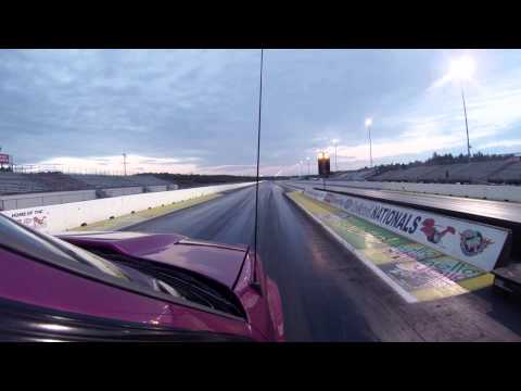

                    • One of the 12 second runs... the only time I got the camera on the outside.
                      Yes I red lighted... lol Exactly why I'm only in test and tune right now... Too bad with r/t and not consistent enough.
                      • Car sounds nice! nice times as well!
                        • that's awesome I wonder what that guy felt like losing to pink beretta lol
                          • It's really not loosing because if it were a real race I actually lost... LOL But yes my car was faster than his. There were a few large CI v8's that I ran that I am sure they didn't expect me to keep up OR go faster than them.
