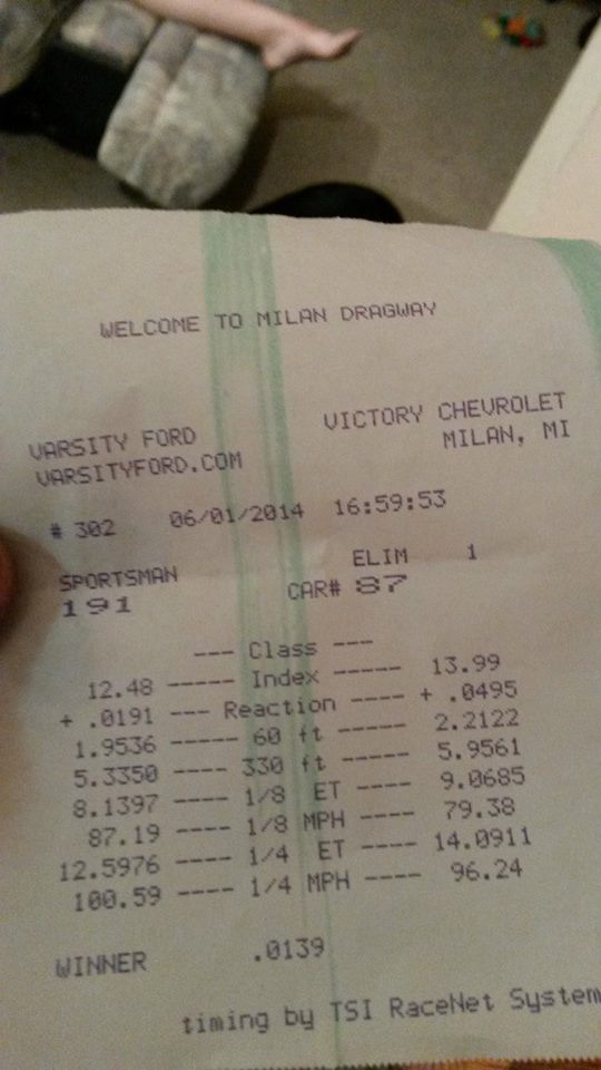

  • Updates if anyone wants to know. Ran it yesterday. Soild 8.07-8.12 1/8 miles. Won my first round with a 12.59@100mph on the brakes dumping at the end for the win on a 12.49 dial in. Their timing system died so we all split the SPT pot and called it a day. Too bad because I wanted to win some more Pts.
    Cars running great. Didn't want to change anything as far as the tune as its solid, conservative, and nice and consistant.

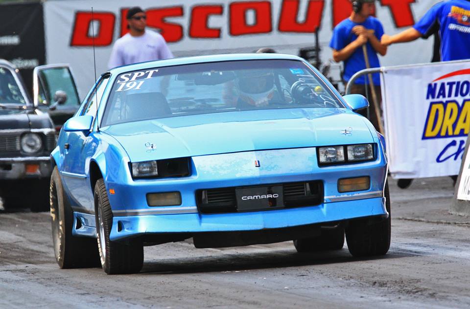

                    • Update 21 Passes later the car is still running good. Solid 12.50-60 car at 13psi. Love the hybrid setup.

                      • How much of an improvement over last year?
                        '86 Fiero, 3500, 4-speed
                        • Originally posted by caffeine View Post
                          Well I picked up about 7mph average on trap speed at the same boost level as last year and picked up a solid .45 of a second on the 1/4 mile time. The tune actually has less timing then last year, but about the same boost. 13psi

                          • Would you attribute thast to track conditions , your foot, or changes in weight to the car ? Sounds like a nice improvement overall And getting it dialed in I always nice !!
                            • Track conditions are always good where i go. This year so far ive only taken it out on days where the DA is average and not very good/hot humid days. Im excited for some cool fall days.
                              The top end hybrid swap did all the work. The car actaully pulls very hard down track now. Before once 5k rpm it would start to slow down and you could just tell that it was restricted. The higerh compression compared to my prevous, the tube headers compared to last years log headers, the dis, the intakes, and aluminum heads, all helped to make the car have a better overall combination on the RPM areas where I use to lack the power i wanted.
