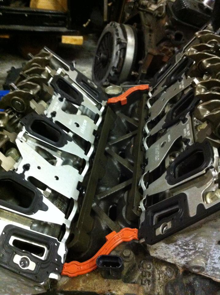

                            Today my cam and pushrods arrived so I installed those and then bolted on the LIM and timing cover/water pump with new gaskets.
                            Installed the fuel pump into the sending unit.
                            And of course I had to test fit the turbo
