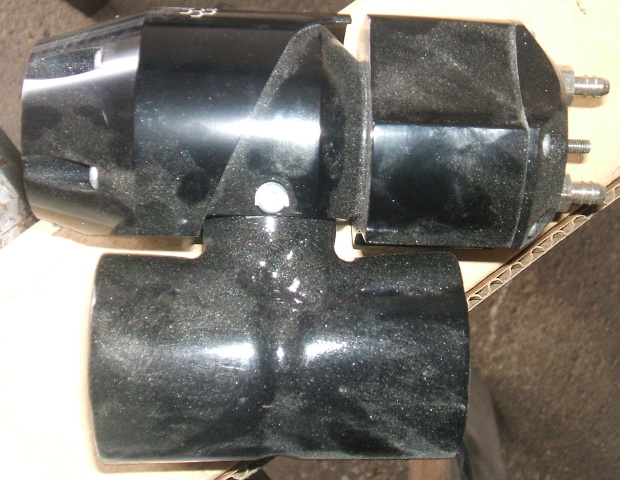

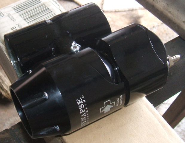

              • I've seen some mounted right on the intercooler. Probably not the best idea in your set up (or maybe it is). But if you run into a hard problem w/ the BOV placement, it is an option to consider. Anything pre-MAF will work, or go recirculation valve instead after the MAF.
                Here is my BOV. The pipe is mildly flared outward and when clamped into place, isn't going anywhere. I would do something similar or something for the silicon to bit on. Like rough sand paper texture, flared ends, tacky paint even works (I know, I tried it).
                But just to show, I did the compact design and it works well so far.
