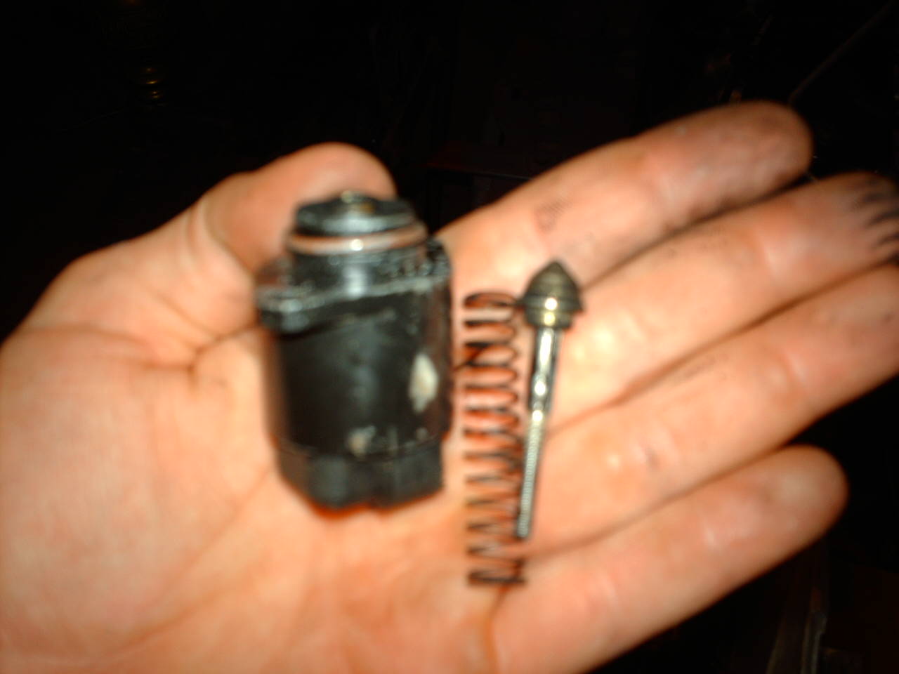

            ok i started it today and i was pulling 15hg dead on
            after awhile the idle would go down to 5-800 and it'd pull 10hg
            the iac was bad i took off and went to pull it out and it all fell apart
            i am going to work on it but will post a full write up later
            thanks guys
            1993 Cavalier Z24, 3.1/3400 hybrid, crane 272 cam, LS6 springs,port and polish,2.5 exhaust to 80 series flowmaster,solid mounts
            • #21
              it runs 100% better sometimes it stalls but very rarely i took it for a drive and no high idle issue when comeing to a stop like i use to have just the idle will dip low and then come back up.
              def alot better
              heres the iac

                          • #28
                            ah ha! I told you so.lol
