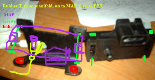

              Syn, made a picture for you. I only spent about 3mins on it, so it's not great or in perspective, but should answer your question about the MAP mounting.
              Put the bracket on the manifold like it's sitting on the table. The way it shows in the pic, the map wire connector side should be facing the firewall, with the actual opening of the connector facing the ground. So you are looking at the whole setup from the "backside" of the motor.
              The "screws" I think have bolt heads on them, and I think they are sheetmetal type threads. They are small diameter any route and thread into the bracket.
