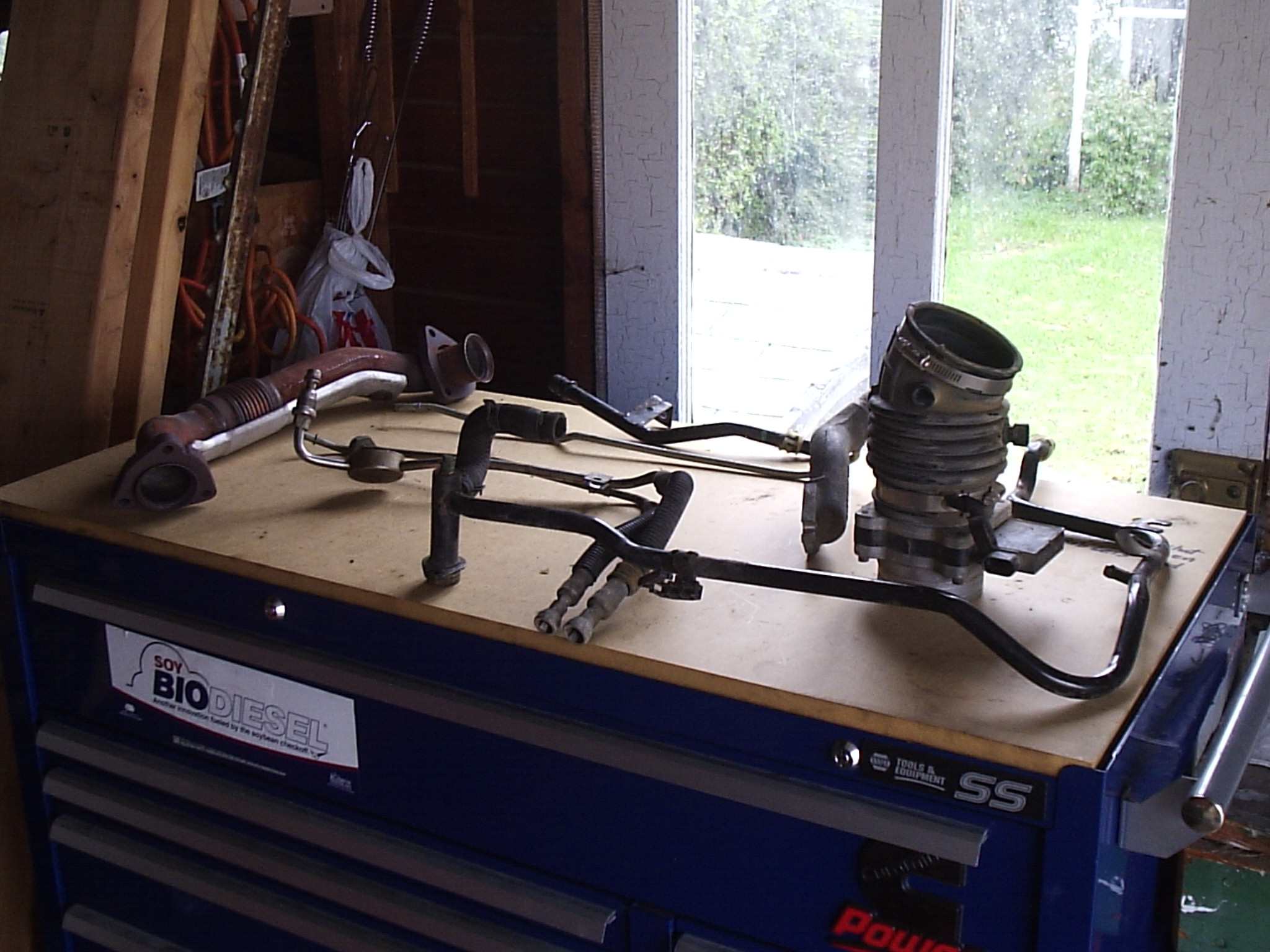

    The lines under the coolant hard line looked more like lines that go to the fuel rail to me. Also that hard coolant line in the back with the bracket (the bracket is held down by a nut to the rear head) looks like the one that goes to the LIM pointing towards the rear of the engine just behind the t-stat and would be for your heater core. The thing beside the MAF to the left covers the t-stat and hooks to the radiator hose on the drivers side.
    Leave a comment:
    replied
    been a while since i looked at a large-port but yeah, all the way left is the exhaust crossover, the towering beast is the MAF and whats snaking around it is a coolant line, goes on the top of the water pump. i think the two lines under it are for the A/C.
    if there is anything else in that pic, i can't see it.

    Take a look back at the picture of those parts sitting on my toolbox. Can you identify those parts for me? I know one of them connects the two exhaust manifolds, and one is the MAF/MAP sensor. Other than that, I don't know what the other ones are. Thank you!

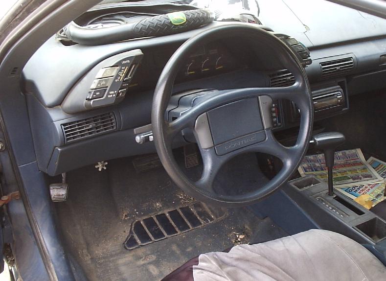

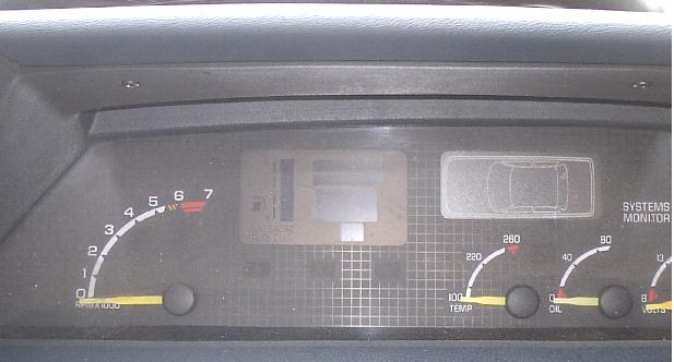

  • 2.8 Grand Prix
    replied
    Look, More pictures!
    Yah I know, it needs work.
    Part-digital dash (only option on whole car)
Name:	Grand Prix 103.jpg
