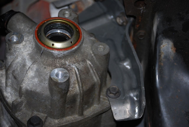

        Yeah, but the pan looks the same as any other 3100 4T60E N-body. However, the side cover has about one inch clearance from the bulkhead er frame and that doesn't include the brake lines.
        Ben, what do you mean by not bolted in there? It sure as hell will be!!!

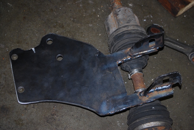

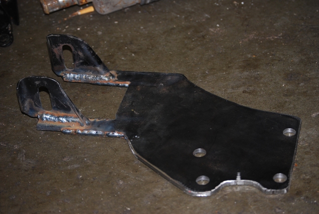

        • #49
          we have a tranny mount bracket welded and bolted in currently hanging the tranny!! need to figure out a dogbone mount, pass axle (will attempt a 97 GA drivers axle), mount and splice the wiring harness, and mod the pass tranny to block bracket, get a shifter cable from a GA, retta, etc., and fab a shifter cable bracket. think thats all. should be done earily next week.

          • #50
            'll get a couple of pix of the modded tranny mount tom. L-body is a good source for ideas and some parts. though, with the smaller engine bay in the Z, you are forced to cut and weld some.
            i do have a few more pix of the tranny and surrounding area if ya'll want to see more.

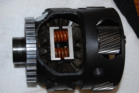

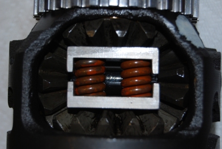

                • #53
                  BLING!! One CHERRY LSD!!
