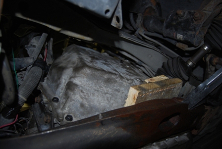

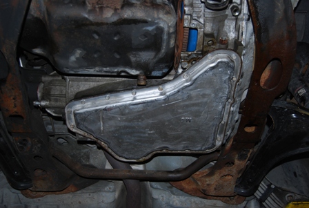

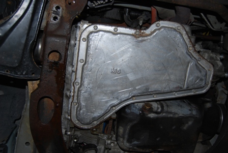

                            • #44
                              here's a few pix!

                              • #45
                                Looking good! Had a chance to mess with the standalone controller yet?
