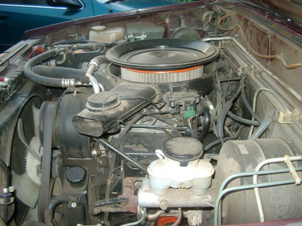

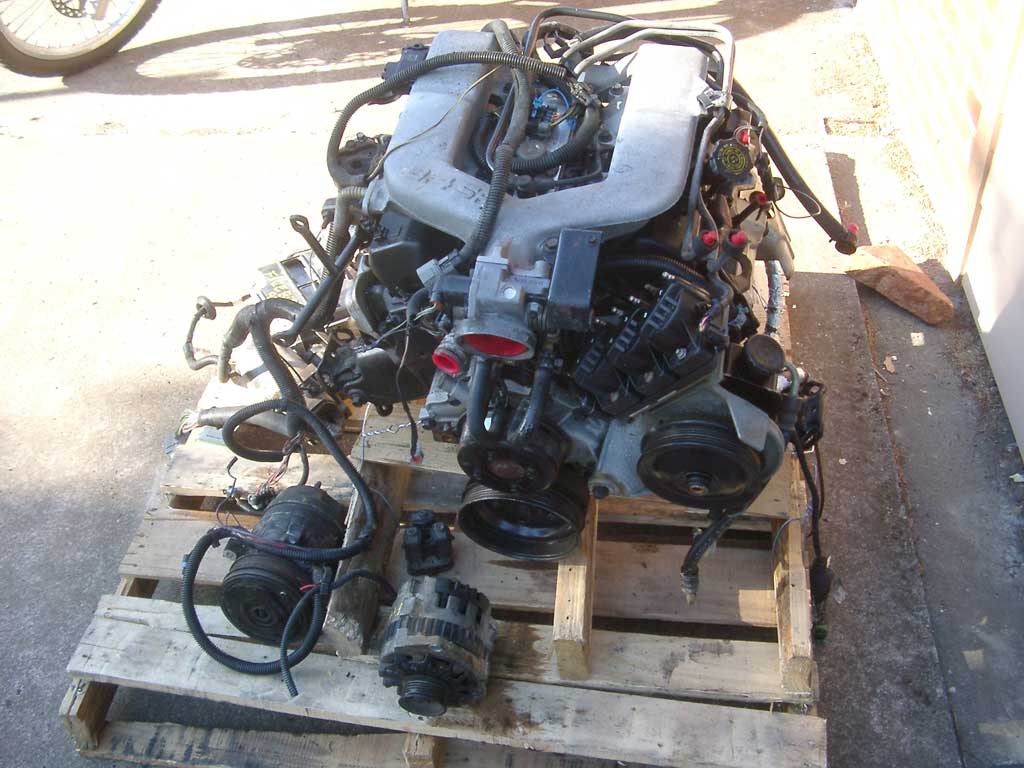

                  Attached are pictures of my new 3.4L on the pallet, and the 2.8L installed. Probably would have been more useful to remove the air cleaner for identification, but I didn't take these pictures special for you. As mentioned, it's just a 2-bl throttle body under there.

                        Well, the pic on the left shows a 3.4 which looks like it's right out of a Camaro, with the SFI injection and all. If you zoom in you can even see the "3.4 SFI" cast into the intake.
                        The pic on the right, with the motor installed, looks like a garden-variety 2.8 (or whatever variant of displacement) with TBI that you'd find in any '89-'91 V6 Trooper. Someone has even done the 'flipped lid' trick on the air cleaner, to gain more flow.
                        Works well, but is quite noisy. I spliced another snorkel (taken from an old S-10) onto the other side of the air cleaner housing, and also 'teed' the vacuum line to the original heat stove, so that after it warms up both heat stove flappers open up to admit air.
                        It's virtually as quiet as stock and flows plenty for the 3.4. If you were to pull the air cleaner lidon your Trooper, you'd see a 2-bbl downdraft TBI with one injecter per bbl.
                        At any rate, as you can see the Trooper 2.8 is just a standard RWD layout, but GM must have had some extra FWD-style blocks kicking around in '89, so it got Morphodited into RWD with FWD starter! Other than the starter layout, the bell housing bolt pattern is identical and any RWD 2.8/3.1/3.4 will bolt up. Of course unless that motor's got the starter on the left side you're drilling new holes.
                        BTW the earlier Rodeo's & P'ups that have the GM-built 3.1 are potential donors for a Trooper engine swap, if anyone were to have a hankering for a 3.1 upgrade. You just have to find one out of a 4WD. The 2WD Rodeo had the starter on the pssgr's side and used a Borg-Warner clutch and tranny, unlike all the 4WD 60-deg Isuzu-GM V6's which used their "MUA" Isuzu-built tranny/xfer case. Also early-90's GM minivans with cast-iron heads and TBI, as they have their starter on the same side as the Trooper's.
                        HTH...........ed

                          Yes, both those engines are mine. 3.4L pulled from a Firebird, and my flipped-lid 2.8L.
                          I went over my harness with some masking tape, a sharpie, and a copy of the wiring diagram. Everything (important) is ID'd and labeled. My engine most definitely came from an automatic equipped car. I'm crossing my fingers and hoping the ECU doesn't mind not having the transmission connected.
