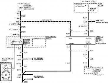

                          I'm wiring my emissions stuff back in. EGR, evap canister, VSS. I pulled all the wires from my old harness to install in the FIS harness.
                          According to the Fuel Injection Specialties docs, their harness would normally only have the purple VSS lead (high). No yellow (low). My Trooper only has one yellow lead. 4000 pulses-per-mile sticks in my head, but I'm not sure if that's the correct application. Trying to find my Trooper manual...
                          Here is a diagram, any ideas which I should plug that into?:
