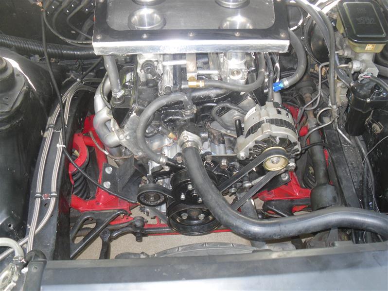

    Your driving a smooth pulley with the ribbed side of the belt? That doesn't make sense to me, and dave is right the WP will not be spinning in the right direction.
    Smooth pulley, Accessory rotates counter-clockwise, Ribbed pulley Accessory rotates clockwise with the crank.

      It's a CW rotating pump we just don't have a 6-rib pulley for it yet. Threw the 3.1 WP pulley on for now.
      Had a 5-rib pulley on it originally

        yeah, it's a reverse rotation pump, they were on Camaro 3.4's I think...

          The pump is from a Fiero. They all have CW Rotating pumps

            was gonna say, mine's a 3.4 Camaro pump and it's like this...

            • #21
              I am running the 3.4 Camaro pump the same way as Superdave.
              • #22
                Ya I think all 3.4s have CCW rotating pumps

                    Well we got this thing started this morning at about 4AM lol. Took a vid with my phone but it didn't save. Oh well.
                    Engine bay is kinda a mess right now and we still have to build charge piping but the hard part is over! Fired up first try!
