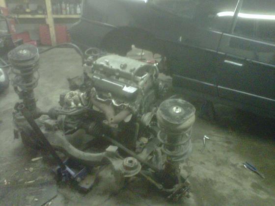

    Old wrecked Cavalier engine is IN (no blower) :
