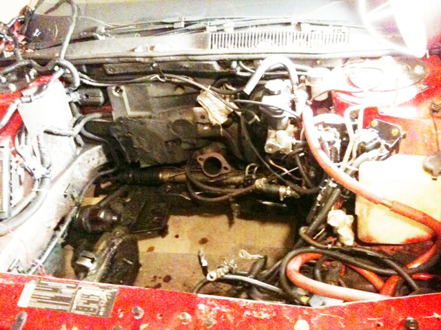

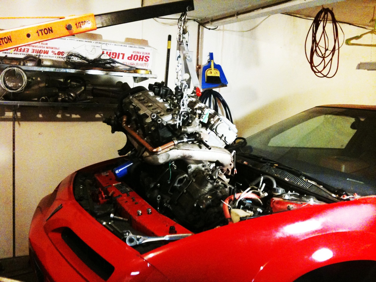

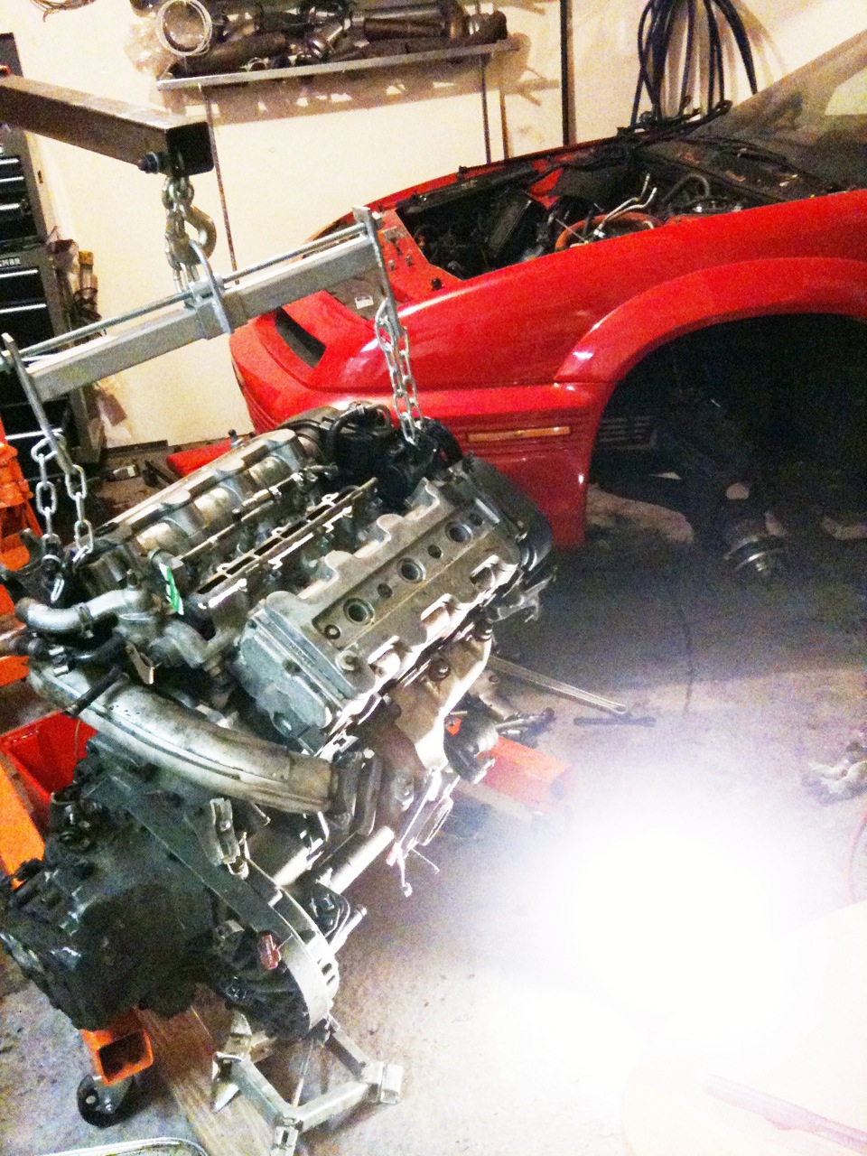

      On to today's progess. Within an hour I had the engine/trans out bringing my total time worked to about 4 hours to go from complete car to engine and trans out of the car, not bad. In fact it all went smoothly and easily. I haven't even suffered so much as a paper cut yet.
      Just starting to pull her out, noticed a ground cable on the bell housing I missed and I was struggling to move the a/c compressor far enough forward to clear the block. I ended up lowering the engine back into the cradle and pulling the radiator out, with the extra space for the compressor to move forward extracting the engine became more simple.
      getting there, a couple nudges and finally,
ID:	376507 Click image for larger version
      the empty engine bay, the 'tray' for the 3100 type motor mount is there and look! theres that socket I lost 10 years ago. Not kidding, it was one of those you drop it and it never hit the ground dammit moments from many many years ago.

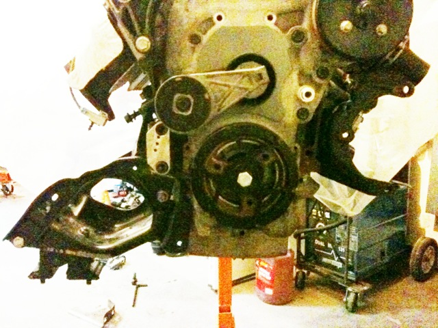

      I pulled the rear motor mount and bracket as well as the bearing mount for the trans intermediate shaft off the LQ1 and mocked it up on the LX9. Everything lined up perfect. The bearing mount bolt holes did need to be opened up just a hair. So it looks like I will be able to use my LQ1 rear motor mount (pictured) and the 3100 lower mount (not pictured, bolts to oil pan) and have a pretty solidly mounted motor.
      The bracket for the LQ1 motor mount uses the 2 bolt holes that the crank trigger CPS uses. Luckily, the thickness of the bracket is the same as the washers I was using to space the CPS out, so I just ditched the washers and it looks perfect - didn't snug it down yet because I forgot to pick up thread locker.
      here is the LX9 with the a/c bracket (which I believe is from a Gen II 3.1 car) and the LQ1 rear motor mount/bracket.

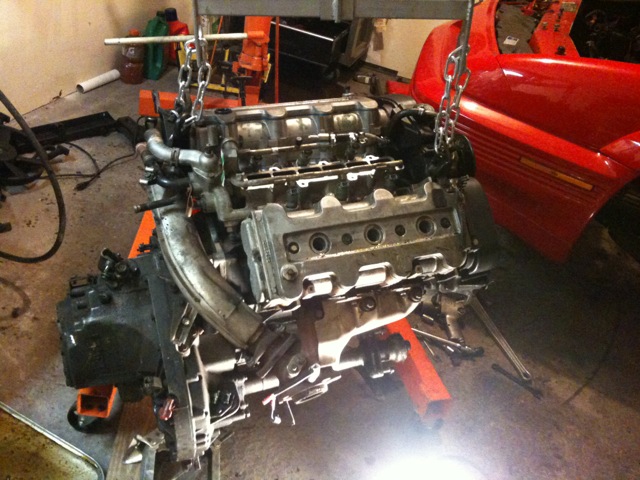

      and one last shot of the dohc:

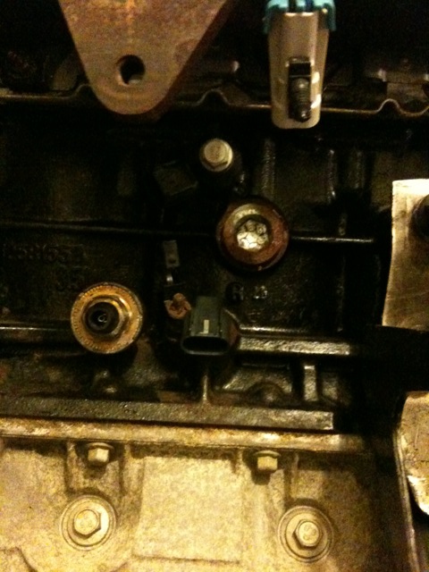

          I removed the CPS from the dohc and installed it in the external trigger on the LX9. The LX9 has a 2 wire coolant sensor in the rear head that looks physically the same as the one in the dohc so I don't think I need to swap. I remember reading a lot about coolant sensor issues in the 3500 swap thread, was that for the single wire sensor? I can't remember if that is the one for the ecm or dash gauge. The LX9 doesn't appear to have a spot on the head for it, which brings me to my next question...
          The LX9 block has two plugs (one each side) that lead into the water jacket. I removed the one on the rear of the block and threaded the knock sensor from the dohc into it. The knock sensor sits lower in the LX9 block than the dohc block, will that have any impact on its reading? I don't think so since knock sound would travel easily through the block. Any thoughts on it? Anyone know the torque spec for the KS? I googled and found 14 ft lbs.
          Here is a pic, you can see the KS threaded in and the bolt above and to the right is actually retaining the stock LX9 KS which is completely unlike the other KS.
          Now, I might just get luck and the plug on the front of the block will be the same diameter as the 1 wire coolant sensor in the dohc head. My concern is that if the ecm uses the 1 wire sensor I'd want it in the head since that is where the temp really matters and the coolant in the block theoretically won't be as hot as the head. Thoughts on this? Its a moot point if the ecm uses the 2 wire sensor because the LX9 has that in the head.
          I began to separate the 284 from the dohc as I need at minimum the flywheel and possibly the clutch should I decide to reuse it. I have the dohc on the crane still and I lowered the trans onto a tranny jack. First I removed the bolts that retain the flywheel shield to the trans. Then the bolts securing the trans to the bellhousing. The trans then pulled away from the engine about an inch but now it is hung up. I think the release bearing is latched or stuck on the pressure plate. How do I get it to detach? It seems I must somehow force the release bearing off the PP. Is that why there is that access hole above the slave cylinder? Just how to I get in there to do it? Prybar? What?

            IIRC, the gauge uses the single wire and the ECM uses the 2 wire in the thermostat housing. As for how to detach the transmission, there was something in my Helms manual that said to take a large flat head screwdriver and place it between the pressure plate and release bearing and twist. Remember how the 284 transmission requires a pull type clutch? Well the release bearing snaps into the pressure plate with a snap ring, sorta like axles do the transmission, IIRC. I've always had a pain of a time pulling them apart, so I unbolted the pressure plate from the flywheel when I did it on the GTP that took part in the tranny swap into the 91. The release bearing was trashed on the 92 and I think that one just kind of fell apart. What is different about mine vs yours is I had no plans on reusing any of the clutch kits in those cars. The 91 got a fresh clutch for the swap and the 92 got a whole new clutch kit as well while I had the transmission off despite just the release bearing being shot.
            • #36
              If the 1 wire sensor is for the gauge only then I'm not too concerned where it goes.

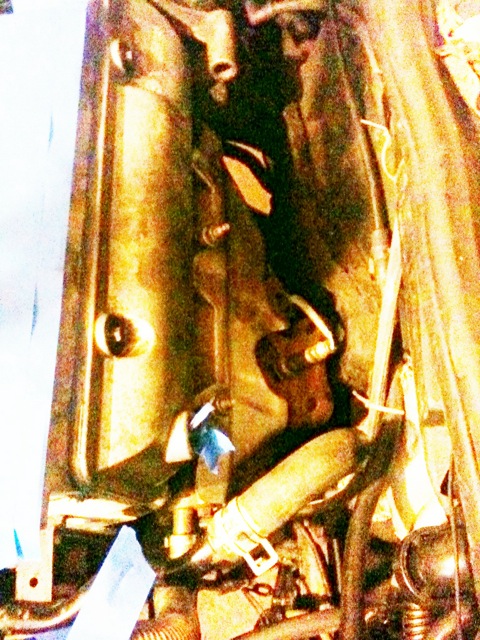

                          First bit of trouble!
                          On Friday evening I decided to test fit the new engine (no trans). I dropped it in and lined up the motor mounts into the cradle and then I still had to support it with the crane since there was no trans on it. I lined it up to where it looked like it would be sitting. The LX9 rear exhaust manifold is super close to the plastic shield over the firewall. Considering I need to make a 90* bend as well that would put the pipes through the firewall. The only question mark here is whether or not I had the engine lined up just right. I think I did.
                          So the dilemma is do I cut out the plastic and see how much space I gain, do I hack up the LX9 manifold and try to make it turn towards the trans, or do I ditch the LX9 manifolds and use 3400 parts.
                          Right now, I'm considering cutting the plastic out and seeing what I gain. Problem is I don't know if that is protecting wires beneath it or something else, or if it is just there to deaden noise from going in the car. I know there has been other 3500 swaps into a W car but did they use the factory LX9 manifolds?

                            I don't think there are any wires right there. It's up to you what you want to do, but I'd use 3400 manis.
                            • #44
                              I cut the plastic back and you are right, nothing but a bit of insulation back there. It gave me a bit more room but not enough. I already have pipes and flanges on the way to make a crossover for the LX9 manifolds, otherwise I would be going with 3400 manifolds now.
                              I cut the flange off the rear 3500 manifold and I was left with a large egg shaped port. I think I can hammer a 2.5" tube to the same shape, weld it up and connect it to the downpipe. The hard part will be merging the crossover pipe in. I feel like I'm obligated to try to make the LX9 manifolds work at this point since the rest of the hardware is on the way. It's just more work than I thought it would involve to make the exhaust work.
