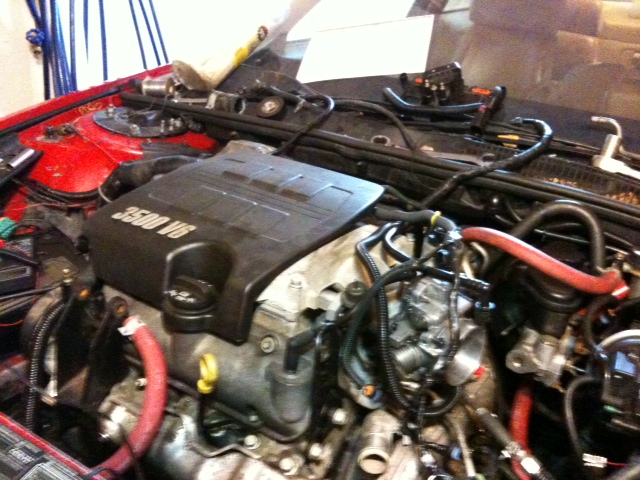

IT RUNS. Finally, I started it up. I just couldn't wait anymore and there is LOTS left to do but all the essentials were there to make it run. I didn't burn the LX9 bin I have yet but it fired right up on the dohc code. Don't have the tach wire hooked up so I couldn't say where the revs were for sure but it sounded to run a bit high, granted the IAC is set to start a LQ1 with a lope and I just capped off the brake booster port and TB vac connections so I may have had a small vac leak. No exhaust on it yet so this thing was pretty loud! Other than that it sounded smooth, didn't smoke, and fired up on the first try. No immediate CEL but I ran it for only a matter of a few seconds, literally, because it didnt have any water in it. I still have lots of odds and ends to finish up and I really want to redo the wire looms - I bought some OEM grade non-adhesive wire harness tape on ebay so I'm waiting on that as well.
Anyway, some pics as promised.

You could have run it longer than a few seconds with no water. Good deal that it started on the first try thoughI fired up the 92 with just the manifolds when I was "fixing" the cat and had the exhaust off- downpipe and all. That thing was loud... It was also up in the air on jack stands about a foot and a half in a garage with a smooth cement floor. I could read my friends lips saying it was too loud, then I reved it to about 2k rpms, lol. That thing sounded like a full blown race car with the lope and no exhaust, lol. Call me hillbilly, but it I got a kick out of it. So yeah, I guess I am nuts

I took apart all the wire looms, bundled the wires up nice and got them into a single loom - it is SO much clearner. I should have the harness tape today to finish it off. I still need to find a brake booster hose, it doesn't look like places like autozone/advance carry it. Need a serpentine belt as well, and probably a lower radiator hose (I have a new one for an LQ1 but I'm not sure it will work).

Worked on it last night for the first time in many days. I installed the radiator, fans, and shift cables. The wiring is all done, as are all the vacuum lines.
I have an early 3100 rear exhaust manifold on there with a dinky 2" outlet. I used it because it would put the downpipe in the correct spot. Truth is, that if it was more centered it would line up better with my downpipe. So I went ahead and bought the superior flowing 3400 rear manifold that dumps the exhaust more towards the middle. Its scheduled to be delivered today. I'm likely going to weld a short lead pipe off the manifold with a ball connection to match the cone on my downpipe. Hoping to get the exhaust done in the next few days. After that all that remains is popping the axles back in, brakes, an intake (the 3.1 airbox I bought won't work, grr... need a 3x00 box I think) and then it should be capable of driving.
If anyone has a 3x00 airbox for cheap I'm interested. I also cannot find a bracket to bolt to the cylinder head (drivers side) for the dogbone mount! As if that isnt bad enough, I found that the 97 lumina dogbones don't clear the radiator support on the 91, I might see if I can modify them to make it work but its small stuff like this that is really getting in the way and costing me more money. Still hunting for a lower radiator hose that will work as well. I'm thinking something from maybe a 3400 impala will work but I just dont know, the 3.4 dohc upper rad hose seems to fit well.1991 Grand Prix GTP LX9swap/Getrag 284 --- SOLD =(
