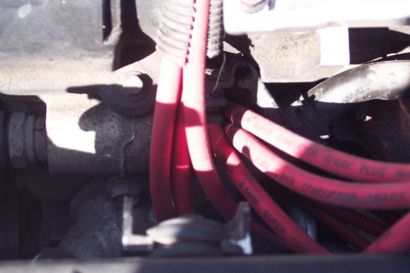

Remove front spark plug wires</p>

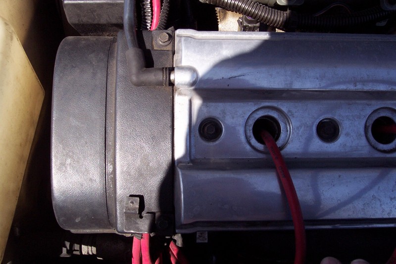

Remove valve covers (4) 8 mm bolts</p>

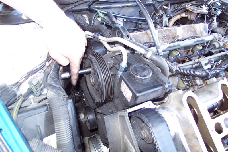

Remove power steering line from pump using 16mm wrench and screw driver. Leave them in place for now.</p>
</p> <UL>
Remove (3) 13mm bolts holding PS pump in place</p>
</p> <UL>
Put the lines into a plastic bag to collect fluid.</p>

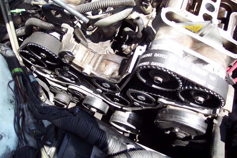

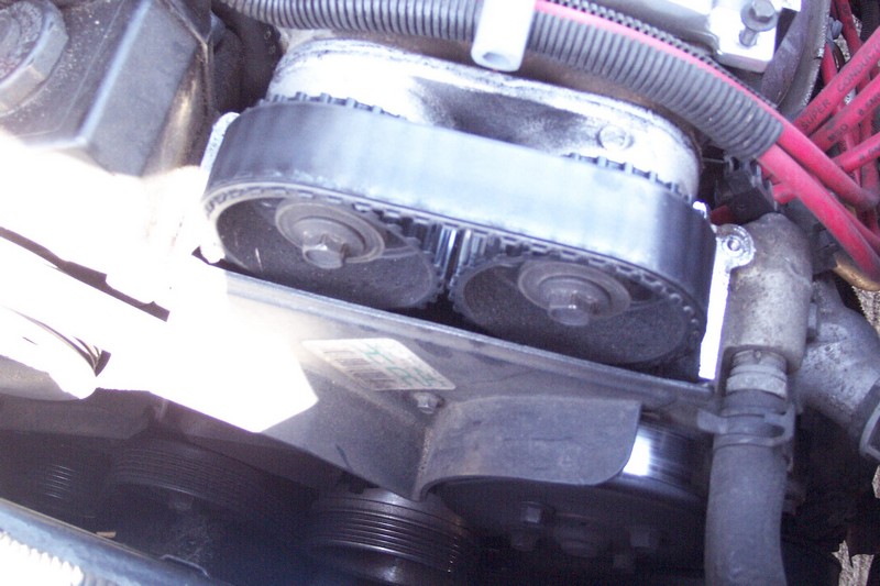

T-50 torx bit is used to remove the idler pullies and tensioner (actuator) pulley. Hold the serpentine belt tensioner down for the 3rd time after pullies are removed to get the old belt off the drive belt gear.</p>
</p> <UL>
Remove (2) 13mm bolts holding belt tensioner in place.</p>
</p> <UL>
Retract the tensioner with a small screw driver. There should be a plastic plug on the end of the tensioner. Remove this and oil should come out (if not, you will be adding oil anyway). Screw the tensioner back in and then use a small paperclip though the rubber plug on the side. There is a small hole in it for a paperclip to fit in. You will have to back off the tensioner some to find the hole inside the plug so the paperclip goes all the way in. Picture is of the paperclip in place and the tensioner ready for reinstall.</p>

First use a 15mm socket to rotate ALL cams with the flats face up. Then remove cam gear bolt using cam gear holding tool and 15mm socket. The rear cam gear will NOT come off without pulling the cam carrier on a 91-93 engine due to the lock ring setup. 94+ can remove all 4 cam gears easily.</p>
</p> <UL>
Install cam flat tools on front bank. Before installing the flat on the rear bank, you must decide what timing you want the rear exhaust cam to be (91-93 only, 94+ can install both cam flats now)</p>
</p> <UL>
Pull cam gears off using cam gear puller (91-93 only) to remove lock ring. Reinstall gears without lock ring and put bolt back in but not tight. Leave about 1/4" space between washer and gear.</p>
</p> <UL>
Rotate crank to desired rear bank timing using 15mm socket and wrench. 2nd picture shows the timing mark on the dampener. </p>

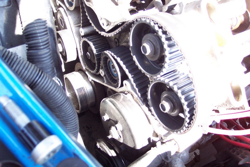

Clean up any black hairs from the previous belt. Put belt in place. Push serpentine belt tensioner down again to put belt on the drive gear.</p>
</p> <UL>
There are a few different ways to get both idler pullies back in and the tensioner with pulley. I prefer to put the tensioner in first (2) 13mm bolts and then the T50 for the pulley. Make sure the nub on the tensioner lines up with the socket part on the pulley. Also make sure the paperclip stays in place for now. After those are in, it is time to put the 2 idler pullies in place.</p>
</p> <UL>
Put the top idler pulley in after the lower one. Do not install either bolt for the idlers until BOTH are in place. You will need to manipulate the belt some to get them in place due to the lip on the backside of the pulley.</p>
</p> <UL>
Now put the bolts in hand tight, and then torque them down.</p>
</p> <UL>
New belt in place.</p>
