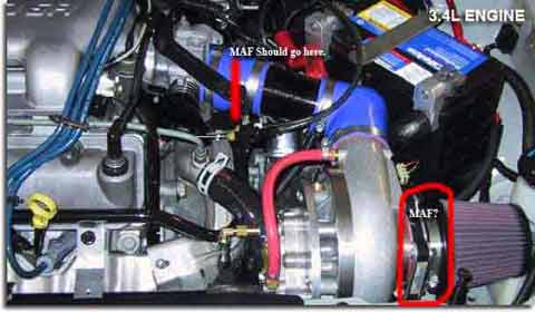

      How do i get a 2 bar map , And would it be diffucult to throw in my MAF.
      Do I just buy a Stock MAF from the dealer and hook it back up pr what. Cause I really want some hope please.....
      • #18
        You can buy a 2 -or- 3 bar map from Pace Performance, GMPD, Summit Racing, Jegs, etc.
        Don't you have your old MAF? Otherwise, go to a junkyard and find one. Heck, you can even hack in an LS6 MAF. It has a built in IAT sensor, so it makes the plumbing easy if you have an IC.

                The computer is designed for a MAF, no getting around it. It's like disabling the camshaft sensor and saying well if the old 3.1 cars can get around w/o one then mine can... It wasn't designed to run without it. Sure you can remove it and it runs, but not optimally.
                Part of tuning and going fast is designing the system to run well. Anyone can throw a power adder on, but the ones that go really fast and make good reliable power are the ones who tune.
                Put the MAF in AFTER the BOV. You might have to go with all new charge piping, and route it away from the SC and TB, put the BOV, then MAF, then route back to the TB. Heck if I were you I would take the time to buy an intercooler that would fit, and route the setup through all that. That would give you more power and less chance of knocking. Then I'd drive it a little and scan for KR and tune in areas that need it carefully. Probably remove some timing in the upper RPM's, etc. adjust fuelign if needed...
                Did you rebuild the engine yourself? You don't sound very "confident" or knowledgable about some stuff (no offense). At least get the MAF in there, you can figure it out. Make sure it's after the BOV.

                        MAF will be easy, you just put it in line with the charge pipe right after the BOV. You might have to shorten/lengthen the pipe or add another coupler or something, but that's it. Then just connect the wire back to it and go.
