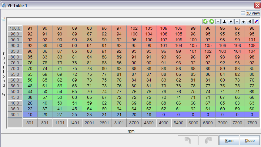

                          alright. made some progress. DIY is clueless as to why I dont have spark control, they want to see the oscilloscope readings.. factory computer controls it correctly.. SO I ordered a scope..
                          In the mean time, I had more tuning done on the fuel side. about few hours on the dyno and an hour on the road. OMFG the car drives amazing! its unreal. basically zero issues. my idle issue was the throttle plate adjustment wasnt open enough, we opened that up a little and he did a little tunning.

                          • #28
                            Nice i agree drivability is the shit.I remember way back when all the random issues i had running OBD1.Cool glad you have everything fixed=)
