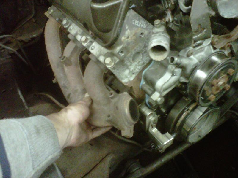

                              How cool would it be if the 2007 Montana manifold fits the engine bay of a third gen Camaro... NICE turbo header !!
                              • #30
                                Thought I would update this..
                                It does fit.
