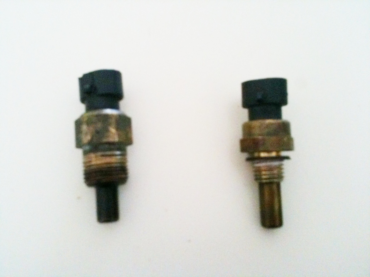

          I'm pretty sure code 15 is the coolant temp sensor. I used the LX9 sensor since the connector is the same but now I'm thinking that the values it outputs (resistance) is not the same as the older style sensors and that is why I have the code. Problem is that the old sensor is way too big to thread into the LX9 cylinder head. What do I do?
          Original on left, LX9 sensor on right

            Both sensors should have the same resistance.

              That would be excellent news, in which case hopefully the code was just set because the sensor was not in water when I ran it for short bursts. I've since filled with water but still have to add some and bleed it.
              The only thing that discourages me about the CTS, is that after doing a few searches I've read some posts about people drilling/tapping the LX9 lower intake to accommodate the older style sensor. I obviously don't want to have to do that considering it is in the car.

                  you could use an adapter to fit the CTS in the head. Thats what im running and I have no problem. I don"t remeber the PN but its in the 3500 swap thread ( sticky). And if you run the sensor not in coolant it will almost automatically go to -49 degree and shoot a shitload of gas in your car. if you O2 is old it will stall and you will plug your cat.
