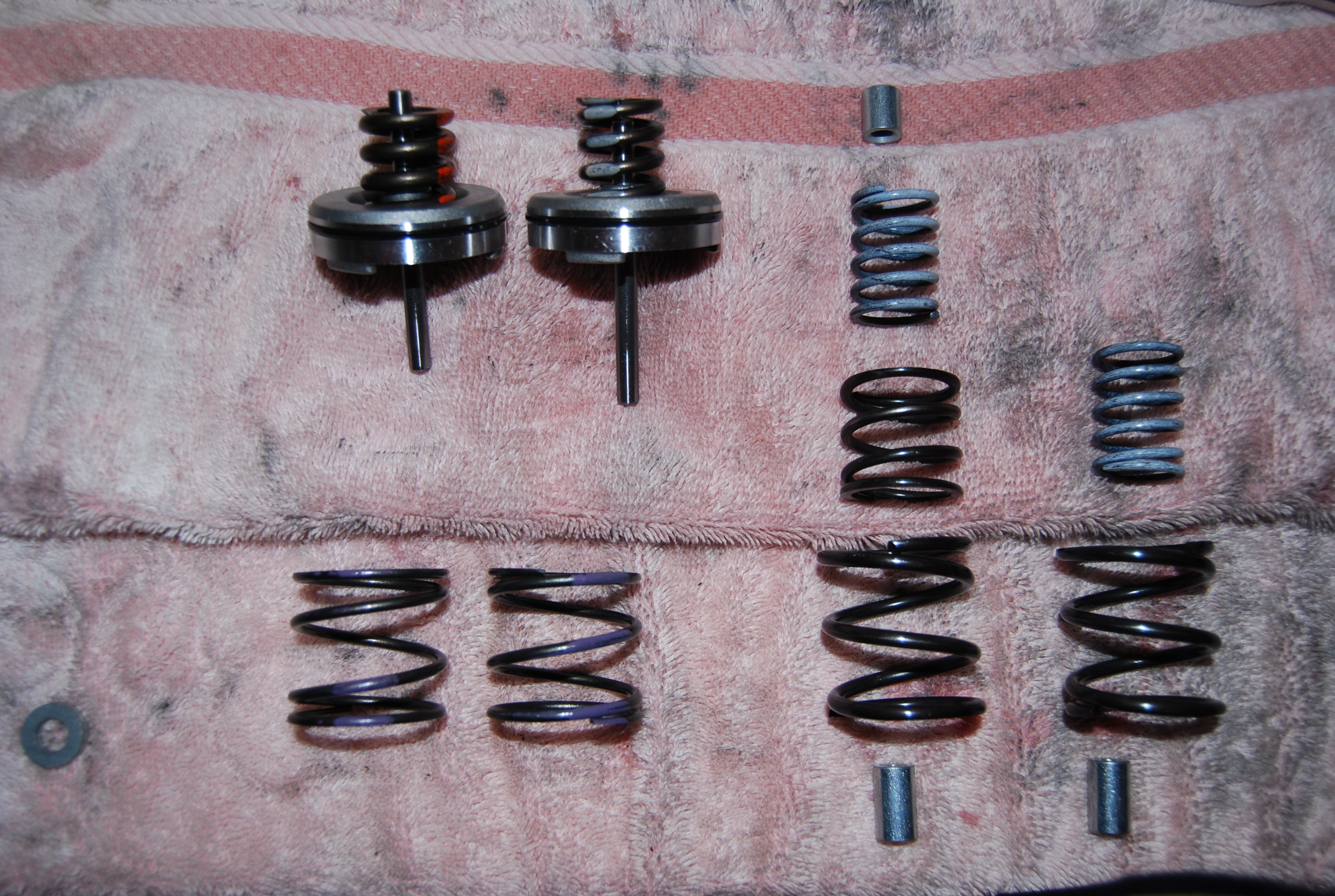

                        install the TransGo shift kit and use Dex VI. amazing difference! i'm going to experiment with a couple of shims. put them where other instructions say to do with my type of converter. you shouldn't need to crank up the line psi much. a few percent will give you a noticeable change, especially with the TransGo kit. check it out below! The left is the stock set up. to the right, TransGO set up. 1-2 has less springs, and 2-3 has more.the orange spring up top both pistions are orange, then white. orange is stiffer. i also replaced the white spring with the orange one. good luck!

                          That's a trans go 4t65e kit, it does not apply to a 4t60e. Sorry.
                          Unless someone has figured out that accumulator pumps from a 65e will fit the 60e case you can't use those springs shims or pistons... the don't fit our assy.
                          I have one of those kits and I tried to fit it once and I believe it didn't work. I could check it again to see if I just opted out because of it looking so different than what I had in there.
                          As far as a 60e trans go kit, you will get a few new valves for the valve body, A procedure on how to change the TCC lockup pressure to lessen the slip with that, and then some plugs and drills for some holes on the valve body spacer plate, as well as springs for th TCC valve, a de-burring procedure for that valve and some other tweaks. They always refer to the 60e kit as a shift correction kit. It should not change the firmness of any of the shifts.
                          As far as my accumulators go, I'm also using doubled up springs in the 1-2 valve. I took the stronger 1-2 outer spring and I bought two of those and then I bought two of the 2-3 inner springs, so now in each accumulator I have the dual spring setup, but using the stronger of the two outer springs. This did improve the shift quickness and quality. Somewhere around 98 or maybe 97 they changed the configuration of the accumulators from what I have in my 96... so just be aware that you may not have the same setup as I do.
                            Ohhhhh DUUHHHH! I forgot. You can't use the kit from the 65E in the 60E. The accumulators are different. Did you shim the pistons at all, or increase line pressure?
