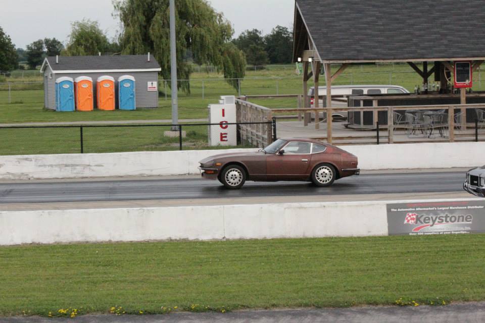

    • Currently I'm running 10 PSIG, since that's the lowest I can run. My wastegate actuator is a 10 PSIG actuator. I plan to really dial up the boost, once I improve my fuel system and gears. I think better matched gears alone will make a noticeable improvement.
      A picture from last night:

      • Nice!
        • Dang nice to see the car and those now rare "headlight covers".
          Grand Prix trans with 3.33FDR
          • The headlight covers really aren't that rare, though these ones were bought back in the early '80's by the person I bought them from. They are an aftermarket item, not a factory head light cover.
            They will soon be coming off, due to the weather cracking, and I don't think I'll put another set on. I liked them, but I think I just want to go without at this point.
