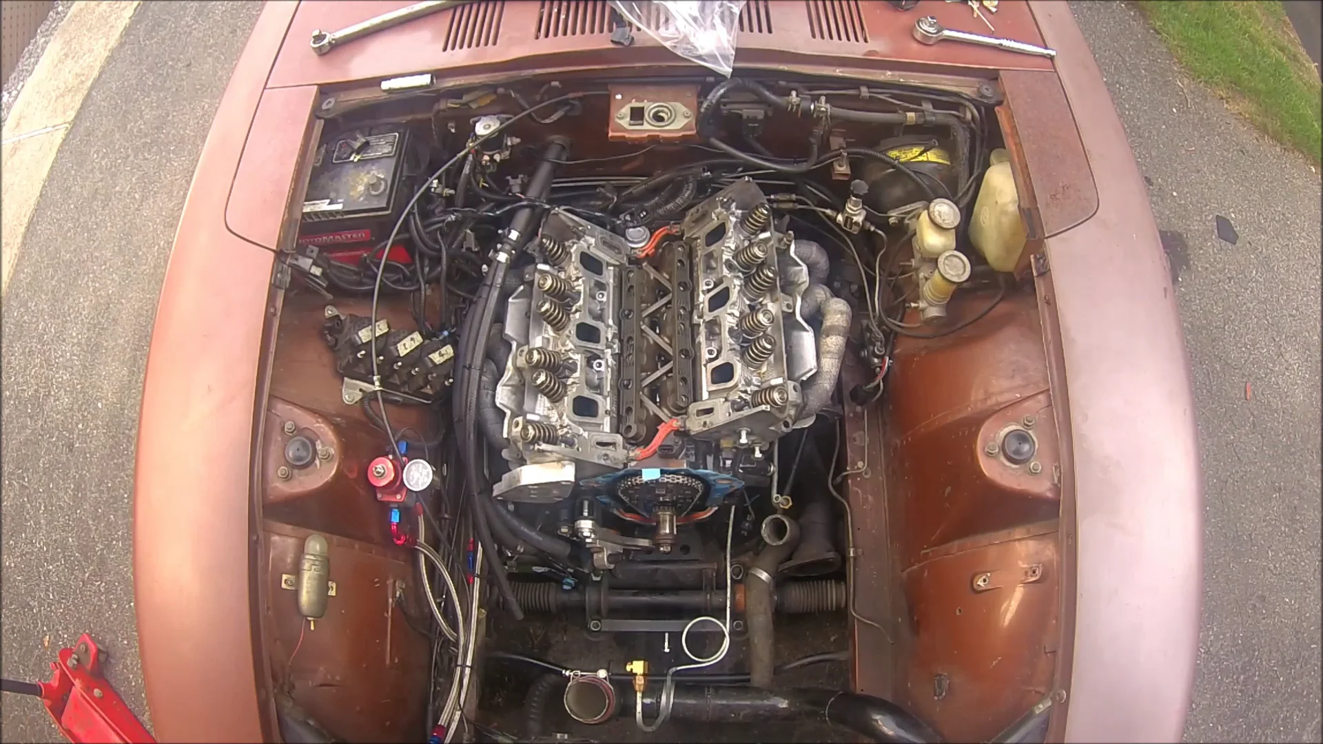

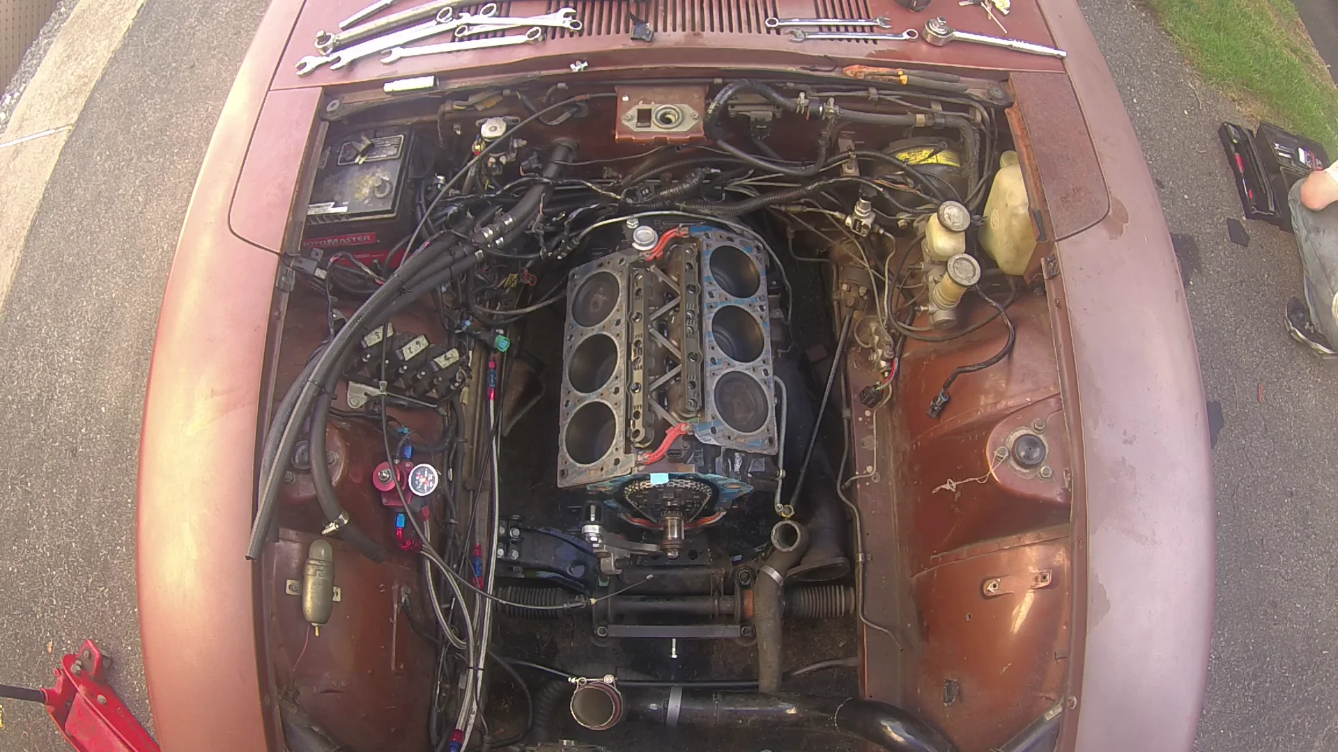

                • Well, no videos of the car in motion, but I did take this time lapse of removal of what was left of the engine in the car.
                  I may edit it later with some music or something.
                  • Is it tradition to do a time lapse video upon purchase of GoPro? I have one somewhere too lol
                    • Must be. lol
                      Not a GoPro, but close enough. lol
                      Mine is a WASPCam Gideon 9902.
                      • Fun to watch. That piece of grass or what ever is on one of the shock mount bolts was bugging me(lol).
                        Grand Prix trans with 3.33FDR
                        • I don;t have a GoPro, either. I call it a FauxPro lol. Swann Freestyle sports cam.
                          • Haha, sweet vid. I always wanted to do one of those.
                            • So I edited the video a bit, cut some of the end off, added an intro title and some (copyright free) music...
                              • Cool video man
