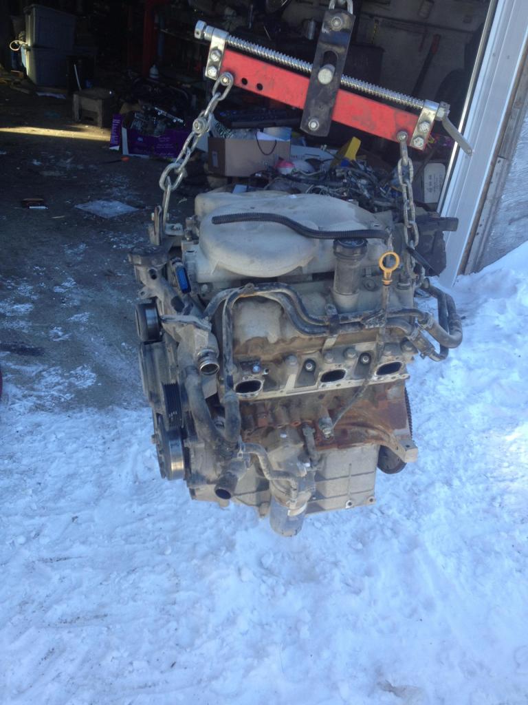

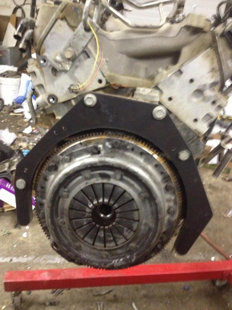

    some progress on my swap:

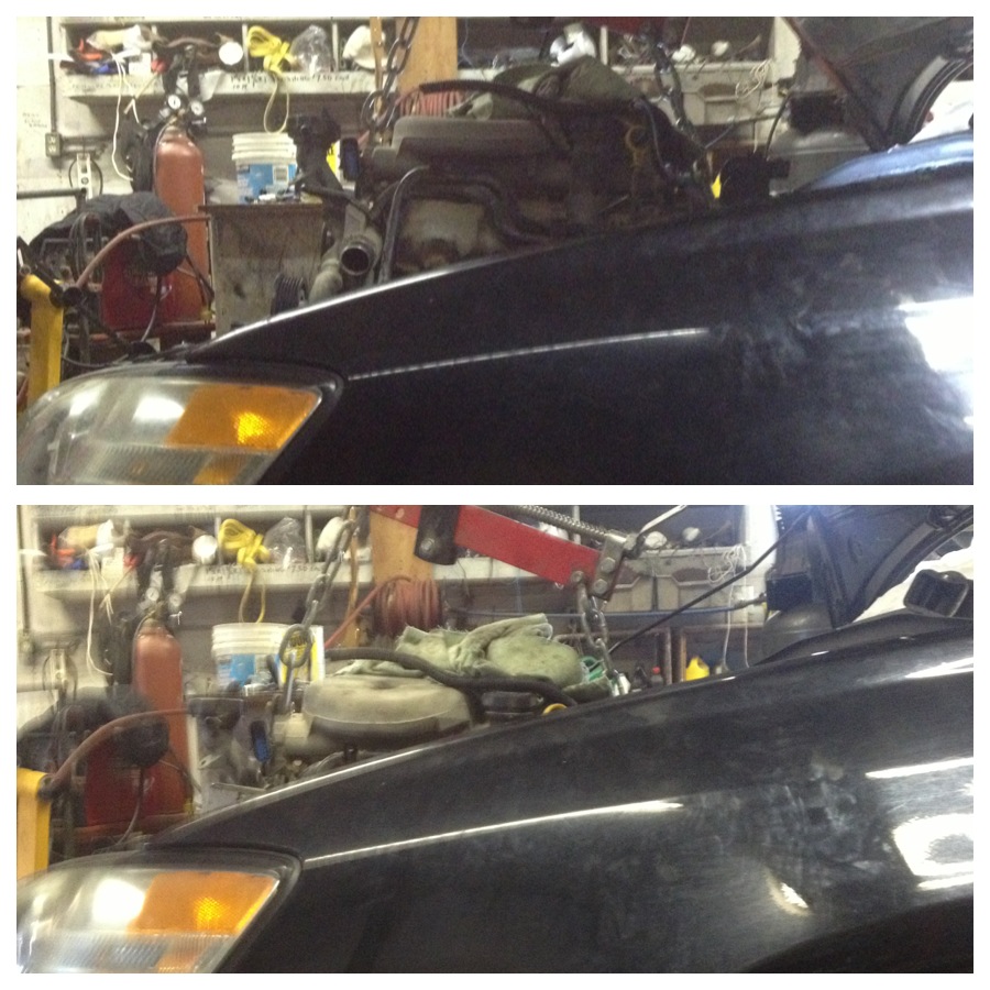

    comparison after moving the trans back an inch, as we can see a scoop will be needed.

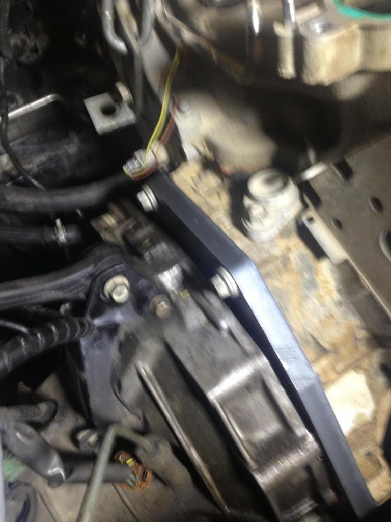

    a few questions:
    -will a small block mini starter mount to the FWD starter mounting location? will the roatation of the starter be correct (doesnt the rwd starter attach on the passenger side of the block (when engine is longitudinal)?

    I thought about doing a similar swap about 2002 or so, but found that the engine would be through the rad, and didn't see much ability to move the trans back. I could have got that car cheap too...
    AFAIK, the coils are dumb coils and just need the negative pulse to trigger them. Easy enough to test with a battery and some jumper leads...
    The MS is capable of driving multiple coils, at least the non-pro versions are. IIRC the pro version was not as easy to set-up for multiple coils.
    Any reason you don't want to use a 3400 starter?
      one helluva scoop.....

          If you go to the gallery, there should be an area filled with images of the engine. To the best of my knowledge, the crank trigger is a 58x. The cam trigger is an odd 4 tooth setup (again, IIRC). Definitely an interesting swap, though!

              raven, i need a snoutless starter, the 3400 one requires a bit of clearance for the bellhousing, the mini snoutless will require less material to be removed. do we know that it fits here? if not i will see...

                      Small update. Had to notch the block to fit in the starter. Going with the 5.3 ls fwd starter so that I have room to make an engine mount where the stock starter would have been.
                      Also had to make the adapter plate 2 piece for this to work.

                              Had to hack up the transmission to clear the starter.
                              Luckily it was only the starter pocket
