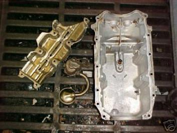

              Now, I am still interested in this.
              How deep is the aluminum oil pan? I'm thinking a lifted Trooper with a diff-drop modification will have an inch and a half greater clearance for the oil pan (Troopers are IFS). Mine isn't lifted [yet], but many people who are looking for more power in the Isuzu community already have lifts.
              • #22
                Here's a few oil pan pics I found in my archives. HTH........ed
                '90 Trooper 3.4 Conversion, bored intake, Holley Big-Bore, 1.6:1 Small Block Chev V8 roller-tipped rocker arms.
