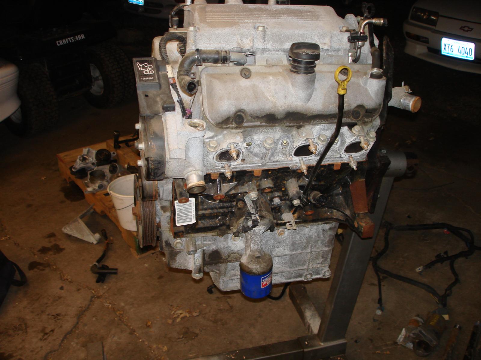

    Would someone kindly post some pictures of the motor mount bosses on a 3500 please? I'm investigating a RWD application in a Trooper for a friend. I can post some pics and measurements of the stock 2.8L bosses and mounts for comparison tomorrow probably.

      This is about the best I have on hand, if not I can head out to the garage and get something a bit better.
      Also you may want to check Dave's gallery (superdave) http://www.3500z.com/Gallery/main.php?g2_itemId=32 (hopefully he doesn't mind me posting that) as you may find something better in there.

          Here are some photos of the 2.8L and 3.4L (F-body). I have two of each engine, one of each with the mounts installed.
          2.8L
          3.4L
            Ok, I'm thinking it'll be a 3400, based on the left motor mounts. 3400 has 2/3 bosses, 3500 has 0/3. I think it will be reasonable to modify the motor mount to pick up another boss. Right side motor mount bosses look good on both.
