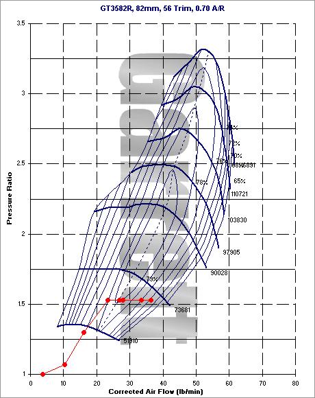

                      yeah to me it seems like it matches pretty good. I want to know why the precision is better (proof) or if im reading the map wrong or missing something. could be very possible! chances are im ordering it sunday or through a local shop tomorrow if they can get me a good deal on it since they will be tunning it. again.
                        the turbo im REALLY considering.
                        not 100% sure if I want the .82 or .85 hot side. going ball bearing due to quality. it will spool faster tho.. is there another way to make it take longer to spool other than swap out housings? seems like electronics boost controllers can help with spool if I remember right.
                          The proof that the new billet wheels are better is the hp, and the qtr mile times that the cars run on them after switching. Be it Precision, or a Holset or Garret or whoever. They are more aerodynamic, weigh less, and stronger materials. They have the ability to run insane boost levels, not that you ever will, because the overall wheel design is better. You will not find any comp maps for the precision billet wheels because it costs too much money to have them done.
                          Also noone knows if you are plotting the maps wrong, because you have failed to show your math in what you are using to calculate your plots.
                          And I am going to correct myself. The 60-1 is a 59mm compressor wheel.
                          a .82 or a .85 isn't going to make any difference in spool. It will be unnoticeable so you can go with either one.
                          • #58
                            Big Cheese is right about the math. Be sure those figures are spot on. It's okay to ask questions about input variables. Better ask now instead of asking why it doesn't work the way the map said it would after you buy it.
                            As a good reference, I use a T04E-50 on my 3100v6. And I love it, spools up nicely while still allowing a low throttle range out of boost for city driving.
                            Now, your block is larger so it is too small for your engine, though just barely too small. So if you map out a T04E-50 and it is just barely too small, then your numbers are not too far off.

                              to me it seems like they would get some maps. guess I cant understand everything... and yes the t04E-50 is just slightly too small.
