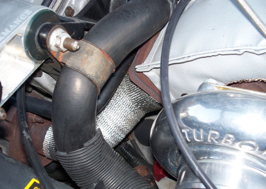

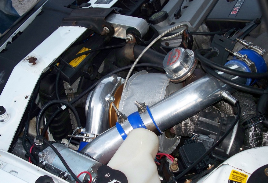

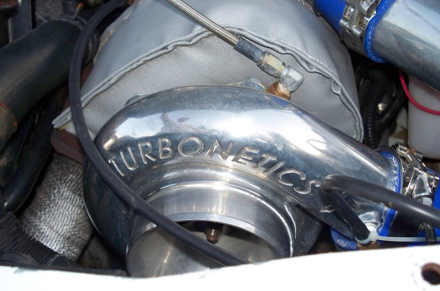

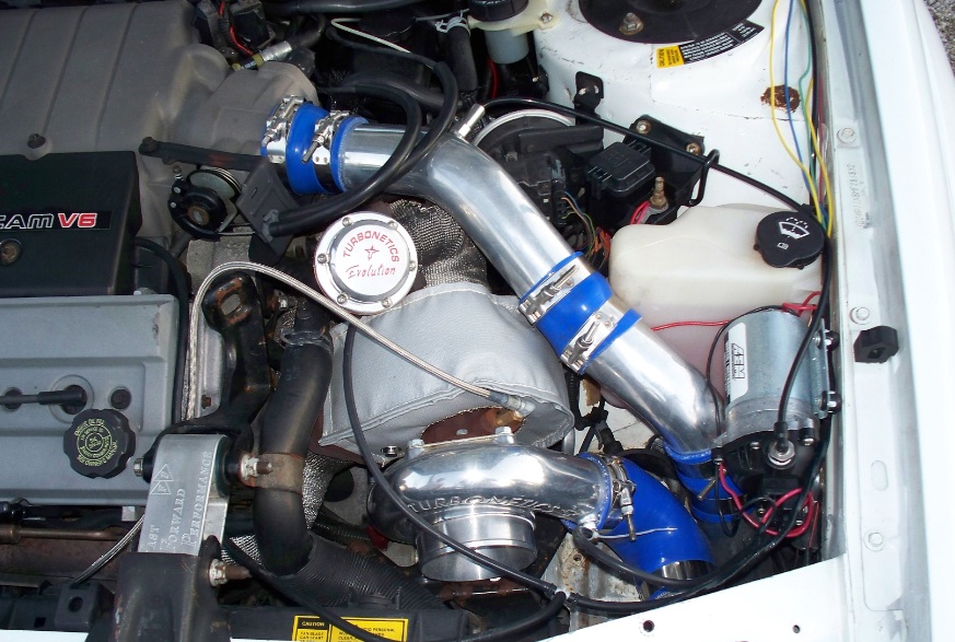

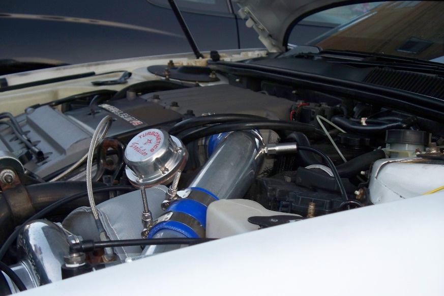

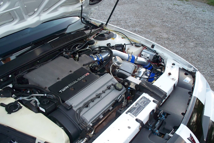

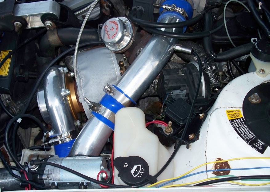

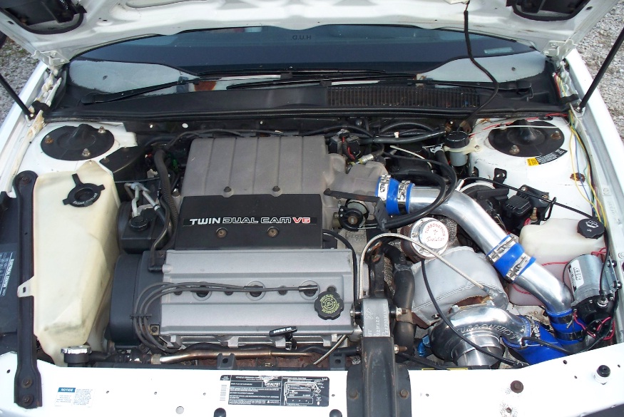

    Alright so ive done alot of work under the hood, replacing garbage couplers and heat wraping the exhaust housing on the turbo, methanol injection is all installed hooked up and functioning.
    I think it looks alot nicer under the hood now, so i snapped a few pics for you guys to enjoy and maybe think up some ideas.
    Oh and im aware i dont have an air filter on the turbo, shhhhhhhhh. lol
    Enjoy
    Jake
    you are planning on fixing that though, right?
      ya of course, i just need a shorter rad, so i can get a proper adapter on there, the car is not an everyday driver, its lucky if it gets driven 2x a month, and the inlet is clean, its pretty blocked off from outside air, so things dont get sucked into it. But yes it is getting fixed.
      Jake
        damm that looks nice........ What other mods do you have such as complete installs of your performance parts. I have a 94 DOHC
          Here i just copied and pasted this from my garage so u can see everything done to the car:
          1991 Pontiac Grand Prix GTP
          5 Speed Manual Transmission
          3.4L DOHC V-6 4 Cam Engine
          Heavy ported upper intake plenum
          Heavy ported lower intake
          Heavy ported heads
          Heads Machined .010"
          Intake cams advanced 6 degrees
          Exhaust cams retarded 6 degrees
          Underdrive pulley
          Billet aluminum engine strut with poly bushings
          Magnaflow high flow catalytic converter
          Flowmaster 40's series original flow mufflers
          Polished Stainless Exhaust tips
          Spec Stage 3+ Carbon Metallic Race Clutch
          Turbonetics 62-1 - 62mm turbo, stage 5, vband, .58 a/r
          Turbonetics Evolution Wastegate
          Turbonetics Raptor Blow off valve
          X02 Racing Intercooler
          Polished Aluminum pipe kit for intercooler piping
          Ford Racing 42.5 Lb/Hr injectors
          GM 2 Bar Map sensor
          Battery relocation to the trunk
          Autometer Phantom Boost gauge
          AEM Wideband 02 sensor
          AEM Methanol Injection Kit
          Custom Made Turbo Crossover Pipe
          Custom 3" Turbo Down Pipe
          EGR Disabled And Unhooked
          AIR Injection Pump Blocked And Disabled
          Front Exhaust Manifold On Rear of Engine
          PCV Vent
          Braided Stainless Oil Line
          Braided Stainless Oil Return Line
          AN Fittings for Oil Return
          Custom Computer Tuning On TGP Code
          17 x 9 Saleen mustang rims
          Limo Tint 5% VLT
          Custom Paint White With Black Stripes
          Custom Gold Pearl Clear Coat
          6000K HID Headlights
          P255/40Z R17 BFGoodrich GeForce KDW tires
          Eibach Pro Street Lowering Springs
          Kenwood Excelon Cd Player
          Kenwood Excelon 550Watt Amp
          Pioneer 12" Sub
          4 Gauge Power Wire
          Sirius Satelite Radio
          Viper XV791 Car Alarm/Remote Start
          3" Electric Exhaust Cutout
          There might be more, but honestly there is so much done to the car its hard to remember everything.
          Jake
            i have nothing to say, but WOW!! can i take her out for a spin once you get that filter on there?
              Lol why wait for the filter, i drive it around all the time without it on. Im thinking about getting one of those slip on ones that covers the inlet.
              But ya if anyone is ever in my area we can take it out for a spin. Its very fun.
              Except not in the winter, its stored durring the winters.
              Jake

                    Wow that looks small for some reason. Header wrap FTW!
                      Yeah there not that big, but definatly header wrap FTW , if i measure the temp with the ir thermometer its a 100*F difference side by side to the wrapped / unwrapped pipe.
                      Jake
                        I had mine ceramic coated then I used header wrap. So cool, it makes cold air intakes jealous!
                          LMAO, nice, i thought about doing that, but i was on a time limit to get it done so i skipped the ceramic coating and just wrapped the crap outta the pipes .
                          Jake
                            Looks great!
                            I just rock a screen over my turbo inlet. has been that way for like 3years. i did recently buy some silicon couplers and what not so maybe one of these days i will have a real filter.. the screen i have is a very fine stainless mesh (took it off a no name cone air filter) and it works good but is a little restrictive. spools faster and makes 2lbs more boost with it removed, but works fine for driving on the street. LOL keeps small childern and animals from getting sucked up in my turbo

                              Ya i was looking at those screen type filters on ebay, there like $10-$30 and its better than nothing, so i think thats the route im going. Im gald you mentioned thats what you use because that pretty much sold it for me.
                              Thanks
