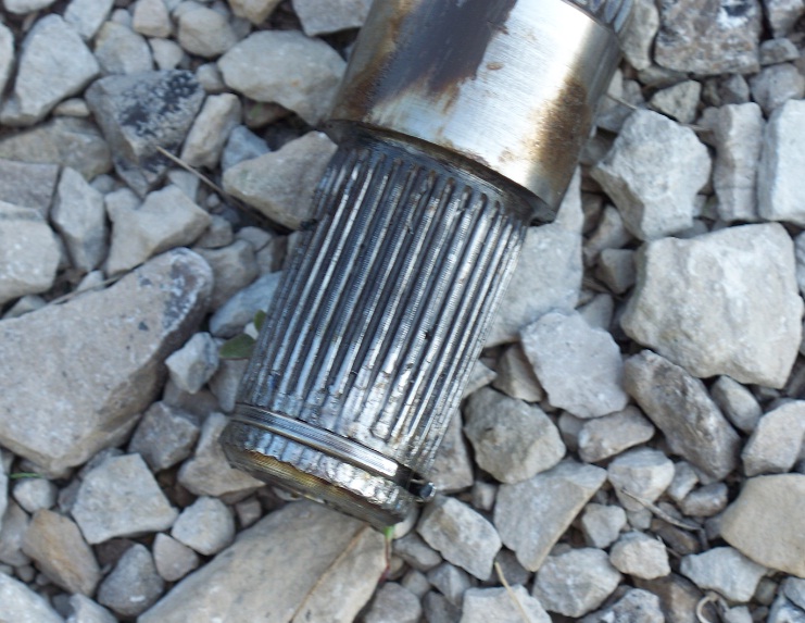

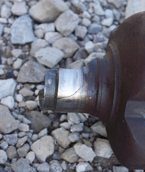

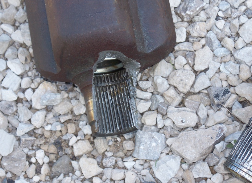

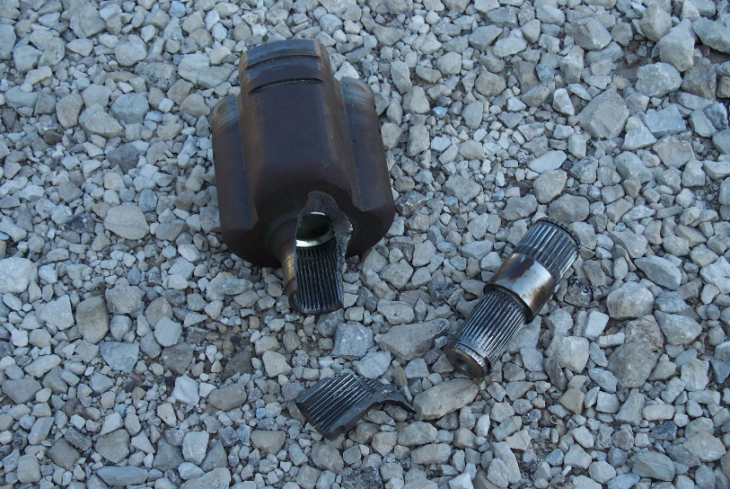

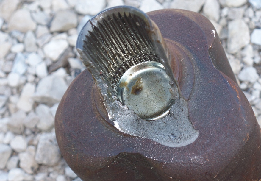

    Ok, heres the Problem, i took my car to the track on friday night, it ran 13.8 with no traction, so i dropped the front tires to 15psi, went to the staging lights and went to launch and the drivers side axle exploded.
    For those who are not familiar with my car, its a 1991 Grand Prix GTP , 3.4L DOHC Turbo, and Getrag 284 5 speed manual.
    Im wondering if anyone knows where i can get stonger axles? the part that broke is the tripot that plugs into the transmission . and here is a few pics.

        as a heads up: 284 parts are few and far between. axles can be easy to find, but you'll probably need to talk to a good local machine shop and have them nitrided or cryo-hardened. also: running sticky tires, especially without a LSD, means death to trannies...

              Thats my problem im just laying to much power to the front wheels on stock axles, eventually they just couldnt take the stress anymore.
