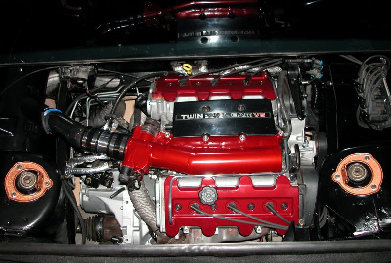

              heres a pic of the swap the one guy started. iirc he said he droped it in on the factory mounts.

                This motor was built by Steven Snyder, he is on the forums from time to and I think he has one of the best looking LQ1's around. Notice he has used two back covers.
                (Hope you don't mind me using your photos Steven)

                  dam that looks really good,anyways i was up at my friends shop today and he knows somone who used to specialize in 3.4 dohc swaps into fireos and builds custom manifolds and some other parts for these motors.
                  so sometime this week im gonna go over there with my friend and talk to the guy, and see what i can pickup for my build
