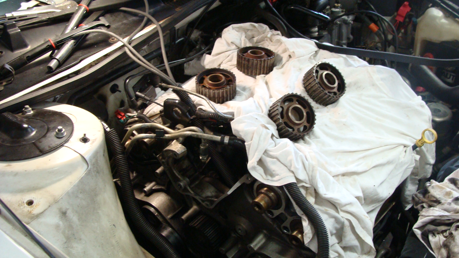

        I know now that there has been two miracles that have occured this time of year, the first is the birth of Christ and the second is this...Click image for larger version

          Originally posted by tincherb View Post
          I know now that there has been two miracles that have occured this time of year, the first is the birth of Christ and the second is this...[ATTACH=CONFIG]5205[/ATTACH]
              I really tried everything before it broke. I used a lot of PB Blaster over the 2 days I was trying. I tried to wedge out the tapered ring with a chisel/screwdriver, used a puller with some hammer taps to the back side. When it broke I was hitting the backside. It started to mov'n right before it broke as I could see the gear sliding on the back side. I thought I was in the clear. The tapered ring never came out. It broke right at the edge of the machining for the cam sensor pickup where a likely stress riser would be.
              To get the other one off, I put channel locks on the tapered ring an sqeezed them as tight as I could get them. Then, I carefully!, tap'd the back side of the gear and the ring easily fell out. IMO, this worked the best! HA! These things were rusted (may or may not be normal) on the shaft. Anyway, its off. I got a nice paperweight in the process!

                Well gentlemen, its complete. I fired it up about an hour ago and no miss. I didn't let it run long because I'm freezing. Ben, you've been a lifesaver in many ways and I really appreciate all you did for me. Hopefully this is the last time I work on this car. Thanks again.
