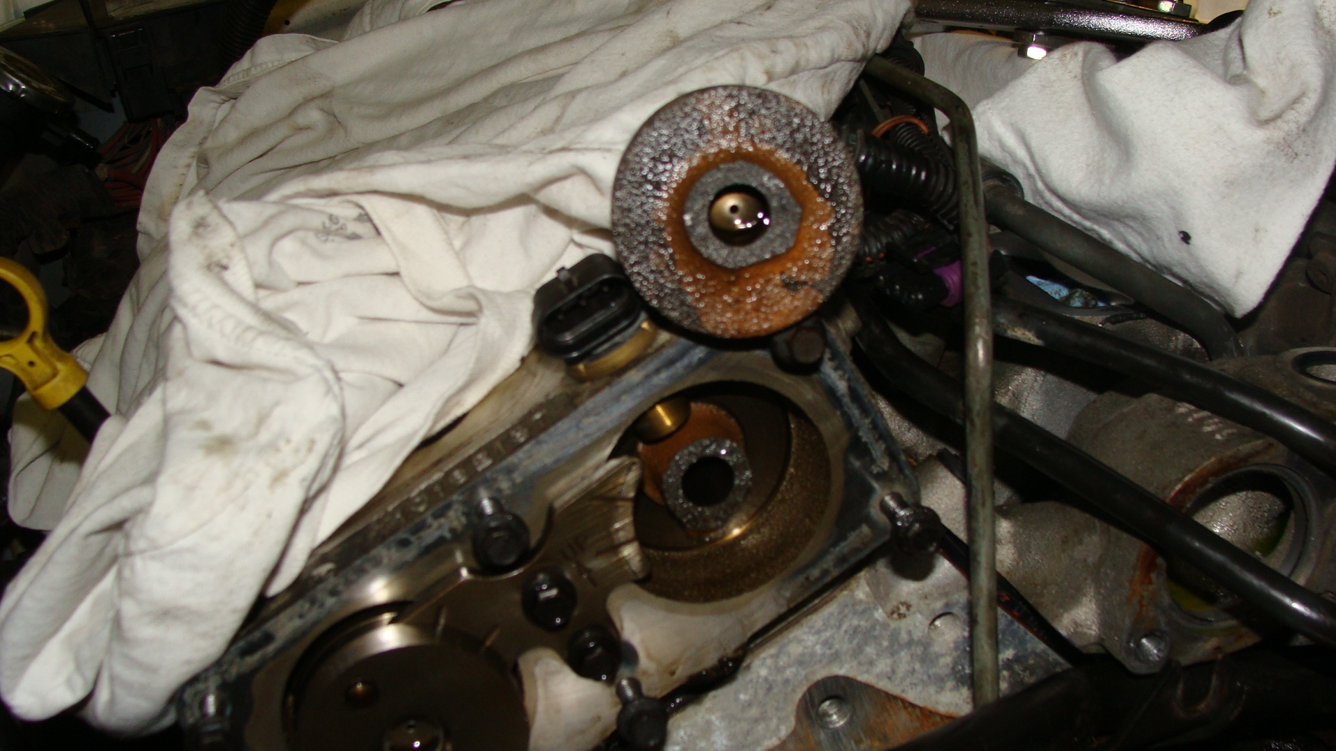

                    Well boyz I did it now. The cam broke!!! Anyone know where to find a cam?
                    • #25
                      • #26
                        Which cam? Pics for sure! Id make sure nothing else is damaged first.
                        • #27
ID:	376446 OK...I'm sick now.
                          • #28
                            Yow... Never seen that happen before.
                            -Matt
                            • #29
                              Thats a first for me and unfortunately that is the front intake cam. Its a 94-95 only item. Looks like it may not cause any damage to the rest of the motor like that though. Ill see if I have one. I know I have a set of 91-93.
