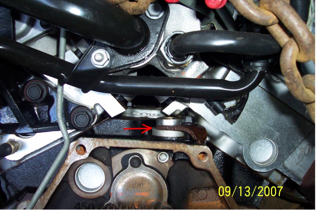

    Here's the text of the fix... The new o-ring can be purchesed from the dealer,,,, just make sure it's the updated, BROWN one. Don't have a part number handy....... Included is a picture I took just before I put the engine in my car.......

              No it IS for the DOHC,, AND,, I haven't done the job myself. There used to be a link to it on this site and I couldn't find it. I HAD copied and saved it, so that's what you see..... Someone elses writeup!!!
              Anyway,,,, that plug WON'T come out without a head removal. It's WAY too long.. You CAN get it up JUST enough to get in there and clean up and slip the new O-Ring over it. I've read about people using a dremel tool to make a notch in the cap for a little more clearence.. Also heard of grinding a bit of the head where it hits as well,, just not too much... I don't believe the last 2 are absolutely necessary and I've heard of people getting in trouble grinding the head... It IS a tight fit, but many have done it over the years Ive had a DOHC. Thankfully I've never had a problem. I've got a new engine in there,,, maybe I WILL have to!!! When I took that pic I looked pretty close and it definately looks do-able!!
