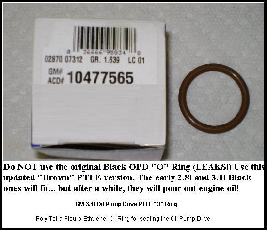

    Oh snap, I forgot:P Yes, that is the correct O ring He sent me 9 O rings:P
    • #17
      donations FTW...i didnt post the PN did i, and neither did u? the 199 wasnt the right one FYI
      • #18
        10477565 is the part number for the silicon tan-colored o-ring. they come in packs of 5 if you order one so just go your dealer and have them take one out of the pile.

        • #19
          correct, that pn gives u a box of 5 and if you are doing a good quantity of them, why only get 1? the whole box cost me like $4 and some change

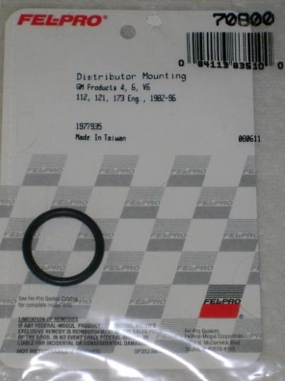

            Just in case the controversy over whether its a good idea to use the original 2.8L, 3.1L "Black O-Ring" is still on-going...the absolute answer is "NEVER!" The problem was solved when GM went to the TEFLON (PTFE) "Brown O-Ring", which solved the horrendous oil leak problems that occurred when the Black ones dried out, cracked, became shrunken around the sealing groove the the Distributor and DIS OPD units. The only problems noted with engine crankshaft, harmonic balancer and other similar seals made of PTFE is that after 175,000 miles of use, they will begin to leak when the PTFE begins to loosen up from around the spring tensioners and begins to "wander" away from where it needs to be from gravity.
            I've included images of both the Black and Brown versions of this infamous O-Ring, which also sport their GM Part Numbers.
