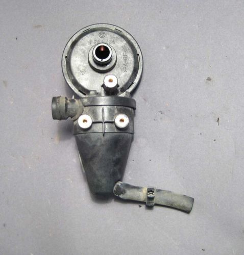

        Another thing I noticed was some of the European cars have a PCV valve and oil separator with very large diaphragm. Many of them seem to have hose barbs so they could be used on any engine. I would imagine the larger diaphragm engages and disengages at very low air pressures and ones with a built in oil separator would be a cheap and easy upgrade to add to any car.
