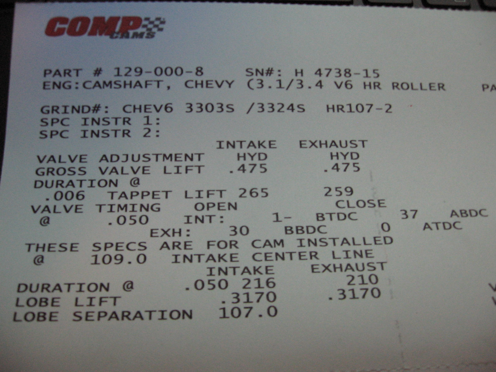

                  Cam timing or ignition timing is likely wrong.
                  What exactly are the camshaft specs? Generally you're describing a very retarded cam, or not enough ignition advance at low speed when using a cam with seat durations over about 280*.
                  This assumes that you've already checked/confirmed plug wiring...a lot of 6-cylinder engines will run in the proper direction if you put the plug wires on in not quite the right order.

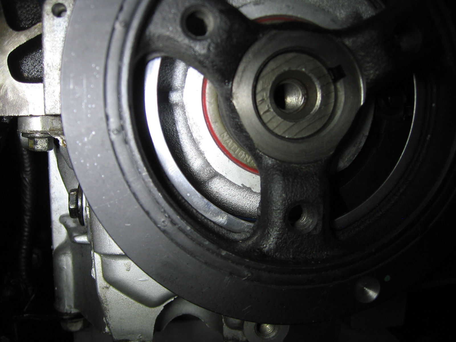

                              Before I go further, is this a normal condition for the hub of the crank pulley to have a gap there?
                              It's like that on every picture I can find of it.
