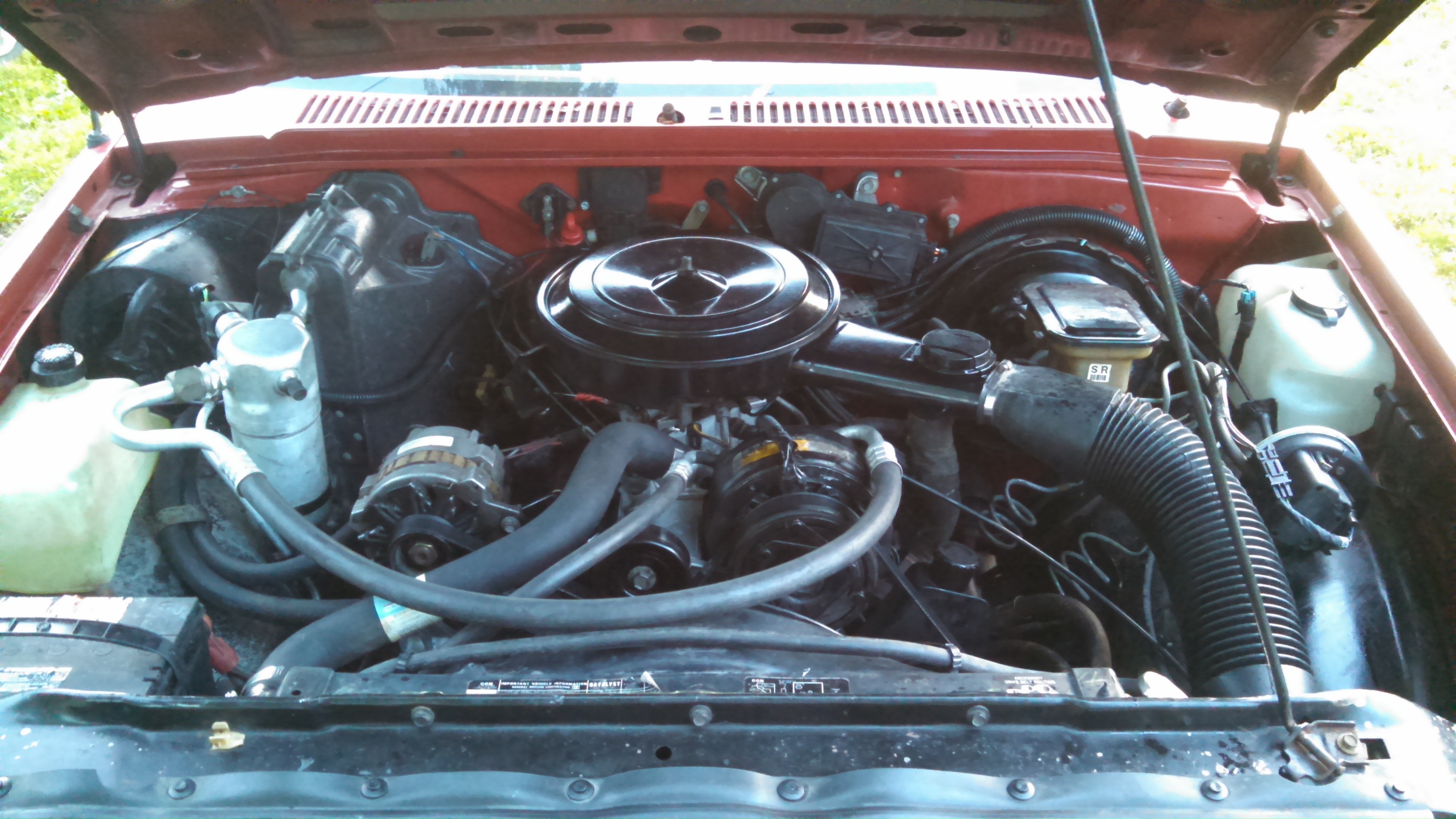

                I ended up putting 4.3 50lb injectors and a adjustable fuel pressure regulator on the engine. Man what a difference! It idles perfect with no drivability issues. I drove it around the house down the back roads for 55 miles and is doing great. I got the transmission TV cable adjusted better where it shifts correctly. The guy that rebuilt the trans did a excellent job. It does pretty good burn outs without having to brake torque it. Really pleased how it turned out.Click image for larger version
