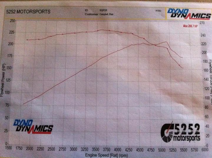

    Should make about 200whp/250ft lbs (torque peak @ 4800 rpm and hp peak @ 5000ish).
ID:	377410Click image for larger version
    With 65mm TB, 3500 exhaust manifolds, crush bent y-pipe, stock Fiero air cleaner/filter.

      So, your combo basically ends up as a stock 3500 (stock TB is 65mm) with a hollow cat (which hurts exhaust flow) and an 80 series Flowmaster (which is not a very free-flowing muffler).. You'll be right around what Caffeine said.
      What type of headers you run will determine a few things, equal length longtubes make better torque and more peak HP. Shorties are less predictable but typically make less torque than LT's however similar HP.
      What trans you have is going to make a big difference on RWHP. Most 3500/5 speed Jbodies are putting down a little over 200 WHP, One that I can recall with a set of WOT's headers made around 215WHP but with some other upgrades like a good exhaust and intake he'd probably be a little higher. That's around 235HP @ the crank. 34hp more than stock application/tune.
