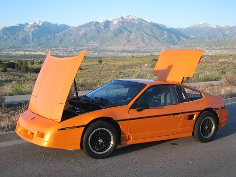

      I was going to start fixing all those when the 88 fell into my lap for a great price, and its in near perfect condition.
      I wont have the space / ability to do a cradle drop till next fall, so was figuring if I can do something to give this a bit more power then the 2.8 gives me id be very happy :P
      heres the 88

      plus, if I have a nice running hybrid to pull, could make some $ back to get the turbo setup done properly :P
