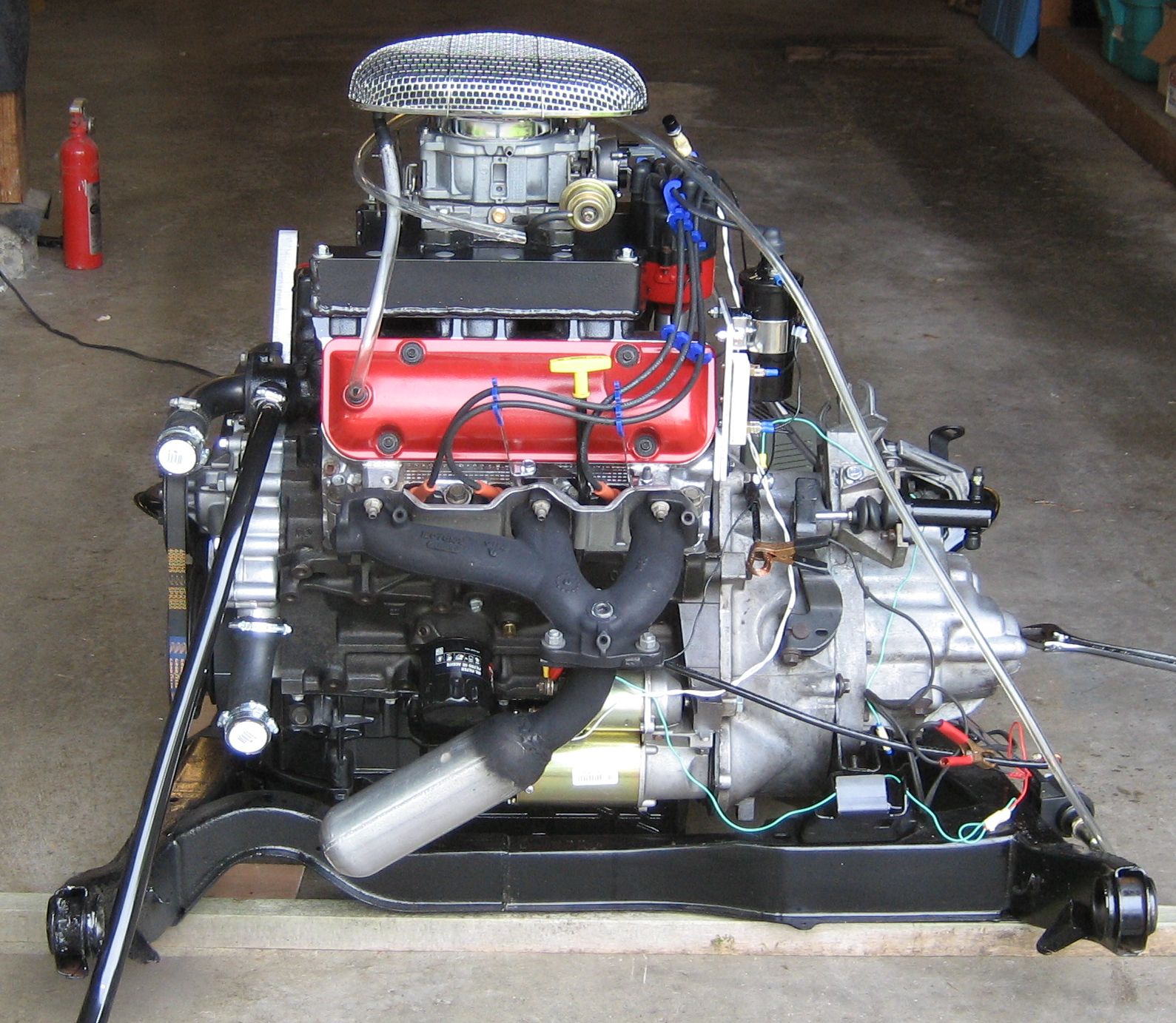

          I built very close to what you are doing, but 3100 heads also the LS6 springs, roller tip rockers and iron head pistons for a 12 to 1 CR. I went with a flat tappet cam in the roller cam block to save valve train weight and used a custom upper with a carb. I did go with a fairly radical cam (some seem think too much). It runs and sounds great. There are some stock exhaust manifolds I used off of an Impala I think, used two front ones, looks like they will flow really well, and will make up a true duel exhaust for it. Larry

            I like that a lot Larry! I like the sound too, is that going in a Fiero? Did you do anything with the bottom end or is it stock 2.8?
            • #21
              It is a stock 3100 bottom end. Yes, it is going in a Fiero. Larry
