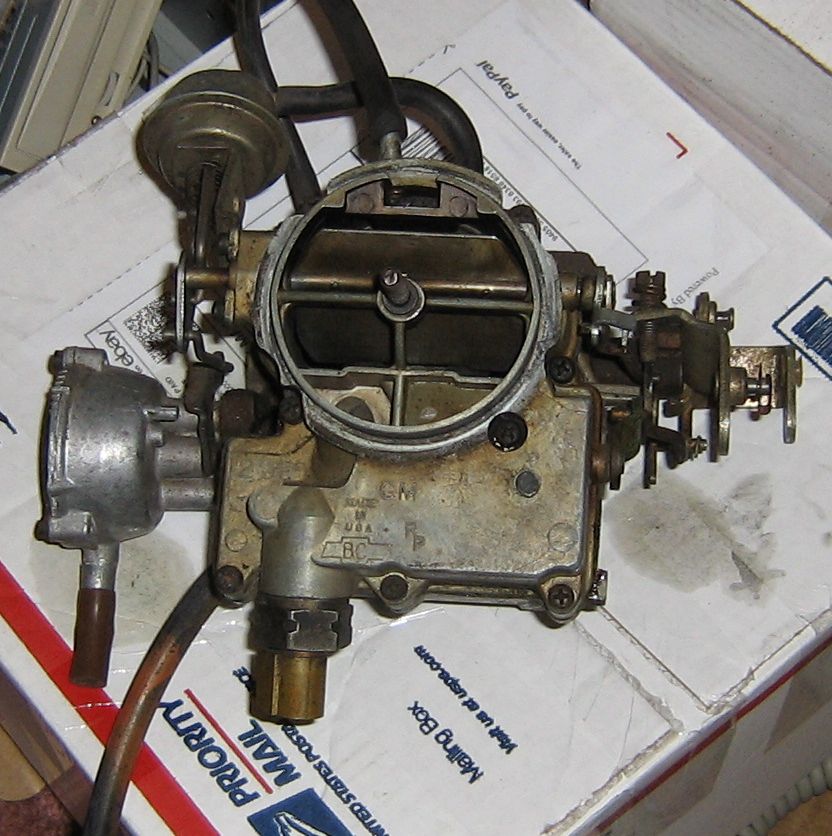

                  I got a ROCHESTER CARBURETOR 2JET (I think it is) I'll give you, probably $10 to ship, was running on a 307 when I got it. Larry
                        [ATTACH=CONFIG]7609[/ATTACH]
                        I appreciate that Larry, but I'll hold off on taking you up on that until I get a manifold to know what type of carb I'll need for it.
                        Thanks again.
