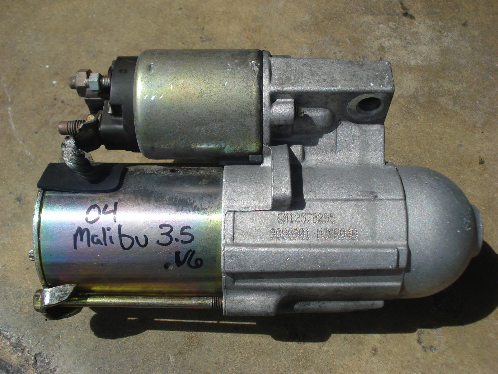

                      I did happen to notice that some of the newer GM V6's have a much smaller (and lighter!) starter. I bought one and will see if it will match up with the Fidanza 2.2 flywheel I have.
                      I have the "step-child" 3.1 out of an Isuzu, so it has the drivers side starter location and not enough "meat" on the passenger side to drill for mounting a passenger side starter.
