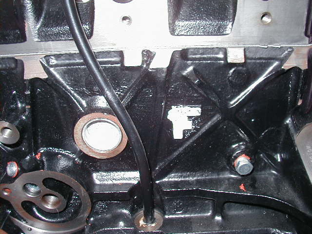

      It is the older 3.4 cast iron block and cast iron heads that was sold as a direct replacementb for the 2.8 V-6 aimed at the S-10 market. I did find a port on the side of the block that I think is a 1/4" NPT with a plug in it. It is above and to the right of the dip stick hole and about 3" in front of the bell housing mounting surface. My oil filter mounts horizonally so I am not sure there is enough room for a tee and both sensors but that would give me a location for the idiot light and the guage sender cound be mounted to the oil filter housing. I have a large "F" cast on the surface of the block if that helps you identify what block I have.
      On the cast iron head 3.4 engine where is the factory water temperature sender located? Click image for larger version
        There are plugs in the side of the block that are routed into the coalant passages you could use. I've used that before when I had to mount a coolant sensor on my 3400. It was on the backside of the engine which would be the pass side if its mounted for RWD apps. Looks like the plug in your pic is what I'm talking about because I think there is a plug on both banks of the engine. You could always fill the engine up and check it at a later date. I changed mine in the car. You loose a little freeze but nothing serious.
        Ummm also 96 beretta/corsicas use one coolant sensor with 3 wires you could maybe adapt to what you need to do. Thats what I did with my 96 S10 because I didnt have the room to use more then 2 sensors. I bought a thermostat switch to run my fans so that left me with 3 sensors, I combined the 2 factory sensors into 1 (96 3 wire) and put my thermostat switch in the drivers side head, the pass didnt have the room bc the dipstick was in the way (this a 4.3 engine im takling about now)
        I'm looking at your picture and using the oil filter location as a reference (I'm assuming and you know what that means) but my oil filter is on the front of the engine which would be drivers side in a rwd app and that plug in your picture (not in the plug in the housing, the other plug) is where my oil pressure sensor is located. Sorry if I'm confusing more then helping lol.
        So this is what I know for sure. The plug in the block on the rear of my 3400 block is a coolant passage and the plug on the front of my 3400 is for my oil pressure.

          Make sure there's enough clearance in those drain holes for the coolant sensor. I relocated my secondary sensor to a similar location on my 3100 and it made contact with a cylinder wall while installing. The sensor failed pretty quickly and the tip mushroomed out almost enough to keep me from removing it again.
          I fixed it by using a male-male npt coupler and a female-female one. The sensor isn't directly in the coolant passage anymore but it still seems reasonably accurate.
