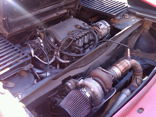

    Here's a pic of my setup. I'm thinking of putting the bottle in the right corner of my trunk. Any problems with this or should i just put it up front in the Frunk? I kinda need that space for my tools though.
    -JoeCooleyClick image for larger version

      i don't know if I'd want my bottle right next to a hot turbo, too much pressure in there, along with a volatile compound...

          well, my mine concern was the pressure, heat+pressure=boom, whether the stuff is flammable or not...
            It would eliminate the need for a bottle warmer, lol.
              yeah, and very possible eliminate the whole trunk too.
                I guess I should have added [/sarcasm] to the end of my post. Text is hard to read peoples emotion at times. I personally agree, putting the bottle back there would be a bad idea. It's not like putting it in the front trunk would leave you no space for simple tools.
                  I caught on to the sarcasm, I just tend not to joke when something has the potential to kill.
