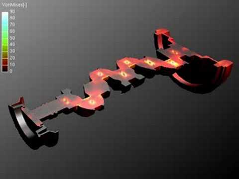

              Every engine that has ever left and OEM factory has a damper. Every endurance racing engine is built the same way. A damper has nothing to do with the balance of the crank or lack there of. Several hundred dollars are spent on a seemingly useless item when the best engine builders in the country build a motor. They wont slap on an OEM damper. They need even more crank protection because they are using stroker cranks and winding them to very high RPM and making big horsepower.
              Imagine a crank from the end not from the side. Every crank throw that the rods are attached to stick out about 1.75" or so. Now ever time a cylinder fires the crank throw is forced down and when that happens it winds up the crank like a spring. The crank then responds by un winding in the opposite direction and it can cycle several times with just one cylinder. Now multiply this by every piston attached to the crank. If you do nothing about these vibrations you will shorten the service life of everything attached to the crank. Rod bearings, pistion pin bores, timing chain, valvetrain and oil pump and so on.
              You may have not seen any damage on your wifes car but if you did a tear down and close inspection you would find signs of damage and the engine will fail in less time than one equipped with a damper. Stock power levels may not test parts to their limit so you can get away without a damper for some time. But thats all it comes down to.
